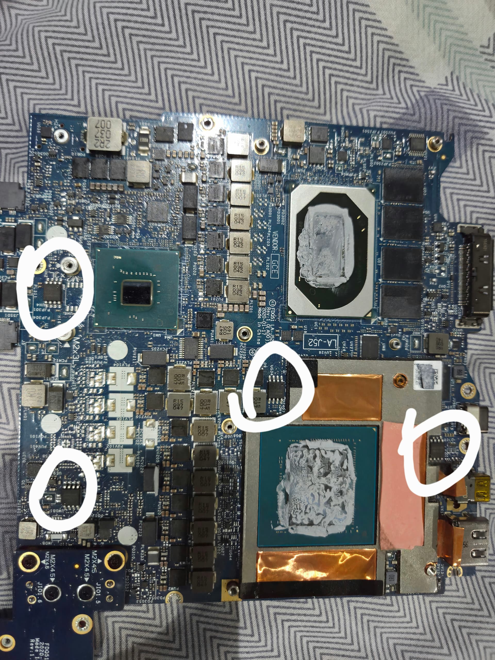

I got the CH341A programmer , but I got 4 chips that look lile a bios chip and i dont know which one is the actual bios chip.
These are the codes :
Winbond 25Q128JVS0 2041
Winbond 25Q80DVSIG 2032
Winbond 25Q80EWS16 2038
FM250Q08A 1909J1G
Google and IC model pdf sheets, are your friends in this and similar situations… they will give you information on Pin connections, voltage range to use and capacity.

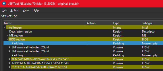

EDIT: You may try now to replace/edit the 2 pads in the expanded SPI image bios region

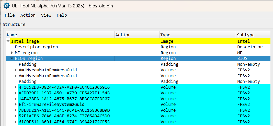

I believe i extracted the old bios image successfully , if any one wants to help me extracting my info and filling it inside the clean bios image please let me know and i will upload the file then.

When i searched for my service tag (dell’s serial number equivalent) i found it inside the bios image , yet when i searched inside the 2 sections you pointed out and even i searched each section inside the bios region(by extacting as is from the uefitool and then opening it with hex editor) and i could not find it so i dont know if i am doin something wrong on my end or maybe it is not saved in the bios region, but maybe in one of the other 2 in the image , also i could not find my MAC address as i dont know what to search for , also when I searched for windows in order to find the activation code i found many windows 10 ,11 entries but could not figure out where is the activation code.
I know there is still other things to search for as well that represent my laptop unique data but i dont exactly know all the required , other than what I mentioned.
So , I really dont know how should i move forward or which sections should i copy in a fresh image , i only managed to locate the service tag for now, and many windows entries that may or may not hold the windows activation code.
Machine info on 1rst padding and Wkey on 2nd padding, mac can’t remember (look for labels on pcb) or share your dump if you want with relevant info from other chassi labels.
EDIT: The info is present, as i mentioned before.
STAG: HC9Zxxx
Wkey: YRWNM-
SC: 37747675xxx
This is my dump file.
Okay thanks , for checking it , so now the procedure that i should follow is replacing the 2 pads that you mentioned earlier in a clean image , and that should be it , or there is still things that could be missing?
Sir… that’s about it, swap or edit, then try one way or another…i process to many info a whole year(s) from all kinds of shxx/machines/models… you get the picture right!
