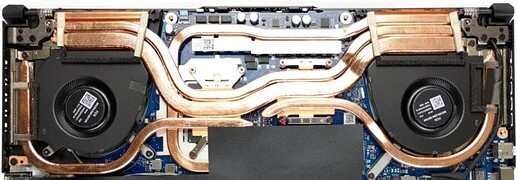

Assuming this is a terrible text translation… you want what all users that bought a laptop for gaming instead of a desktop system… a “fix” for heat over heat over heat and the system throttles down.
PIPES…miles of PIPES
Brands want to sell, sell, sell… users, simply ignore laws of physics, electronics circuits physics.
Laptops are useful for working/mobility, that’s it, a gamming laptop will never have the life spam/performance of a desktop.
Repaste it, clean the ventilation and SELL IT, buy a desktop.
