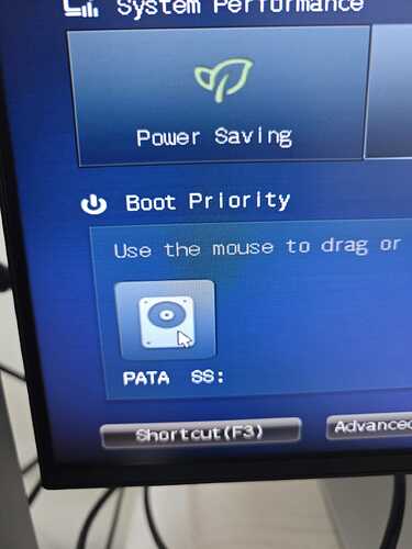

Small update, I succeeded on my ASUS Z87-K using FreeDOS and AFUDOS and made sure to replace the FD44 with the backed up one from the MoBo. I used the UEFITool v0.28.0 making sure to check padding against the original BIOS image. It boots from the nvme on the PCIe slot with the converter PCB. Crazy… I can provide the files if interested.
