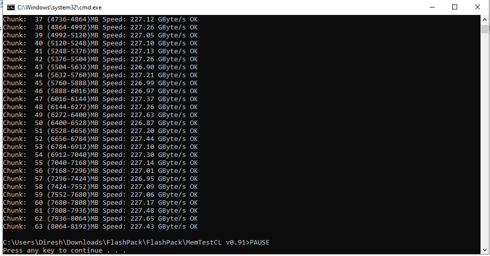

I have an rx580 8gb, also samsung memory. It seems like I can barely overclock this card. At the moment I am at 1370mhz gpu and 2030mhz on the memory.
After a lot of trial and error playing with the memory straps I have this strap stable without any errors
777000000000000022CC1C00316A5D57F059111836CDA60B0060870012081420FA8900A00300000017113A46BA354019
memory bandwidth is at 227gbs
Is there anything else I can try to tweak?
@ghost246777 there isn’t a whole lot you can do to improve bandwidth further but you can try this strap, might improve a tiny bit. 777000000000000022CC1C00106A5D4DE05911163A8D160B0060870012081420FA8900A00300000016163A46B1354019

@ket Heya, so funny story. I tried out @ghost246777’s strap and it easily pushes 227 GB/s flawlessly on my card without any apparent errors… I’ve been spending hours trying to figure out why, since lately after my last bios mod (which was a while ago, so I don’t remember when) I only was getting around 216-217 GB/s and my current bios wasn’t too dissimilar.
Turns out that on their strap, there is one value that’s different than mine under the MC_SEQ_MISC section. Mine is 0x20140824 and theirs is 0x20140812. Changing that heavily changed the behavior of the memory - anything 2150 & above now crashes instead of just begrudgingly running with errors, but @ 2100 (which is relatively stable afaik) I push easy 227 GB/s. With their strap as a base I also managed to close my CL down to 20, but it didn’t actually seem to provide any bandwidth benefit below 23 (still working on testing that).
