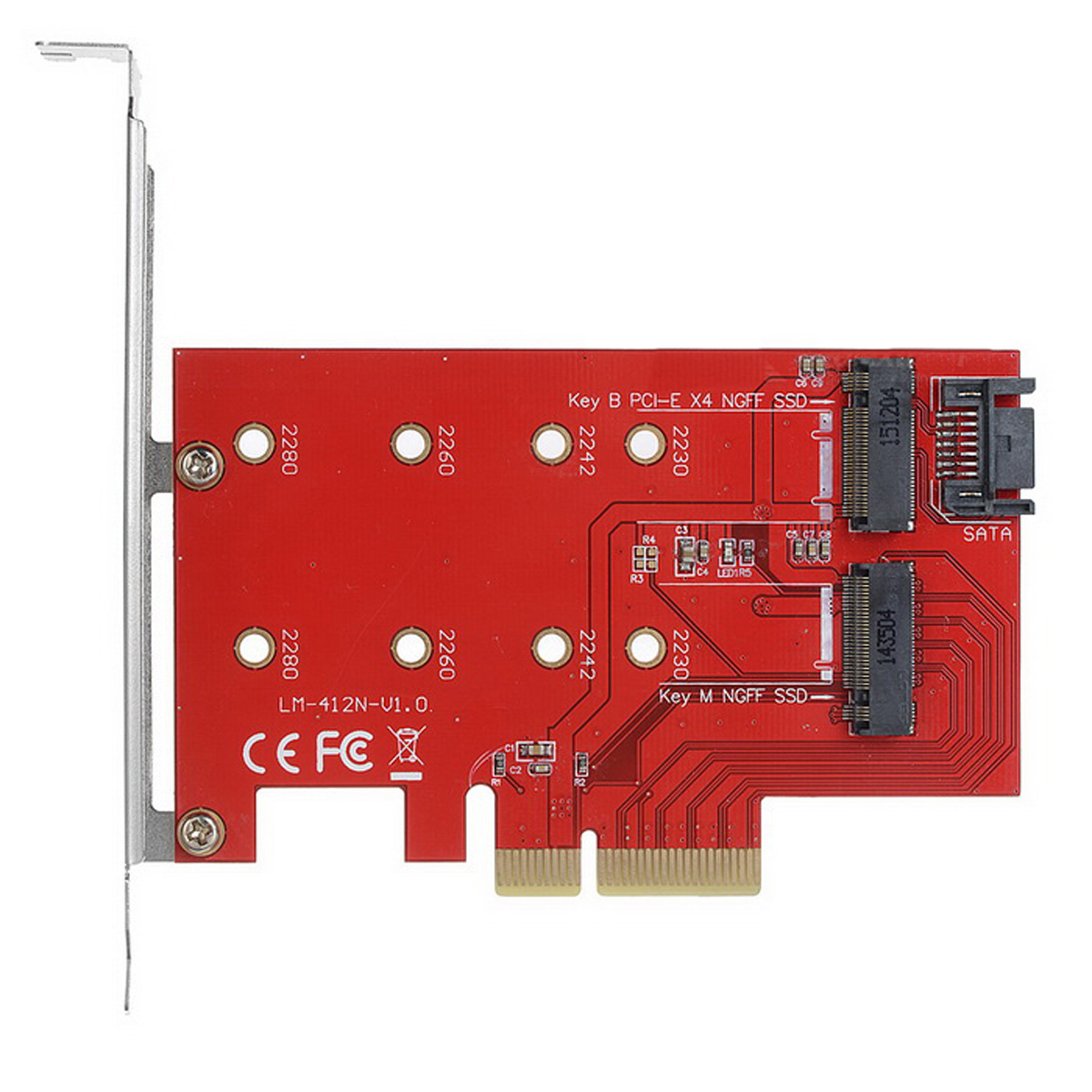

So Fernando, I have another question for you. Im still waiting for my new adapter card to come in, but I noticed somthing while looking mat the other one I have lying around.
https://i.ebayimg.com/images/g/6KMAAOSwE0JY~W0Z/s-l1600.jpg
See those two spots on the pins, where there are only half pins instead of fully connecting to the bottom? What affect do those two half pins have on the functionality of an adapter card? Would that cause it to not be detectable as a boot device?
Here is a picture of the other card I ordered (the one ive used in the past multiple times with success)
https://i.ebayimg.com/images/g/f3IAAOSw7ehXRpcI/s-l1600.jpg
Notice it has a full pinout into the expansion slot.
@Smoblikat :
Unfortunately I don’t know the answer to your question.
Hi Fernando, help me out if you can!
