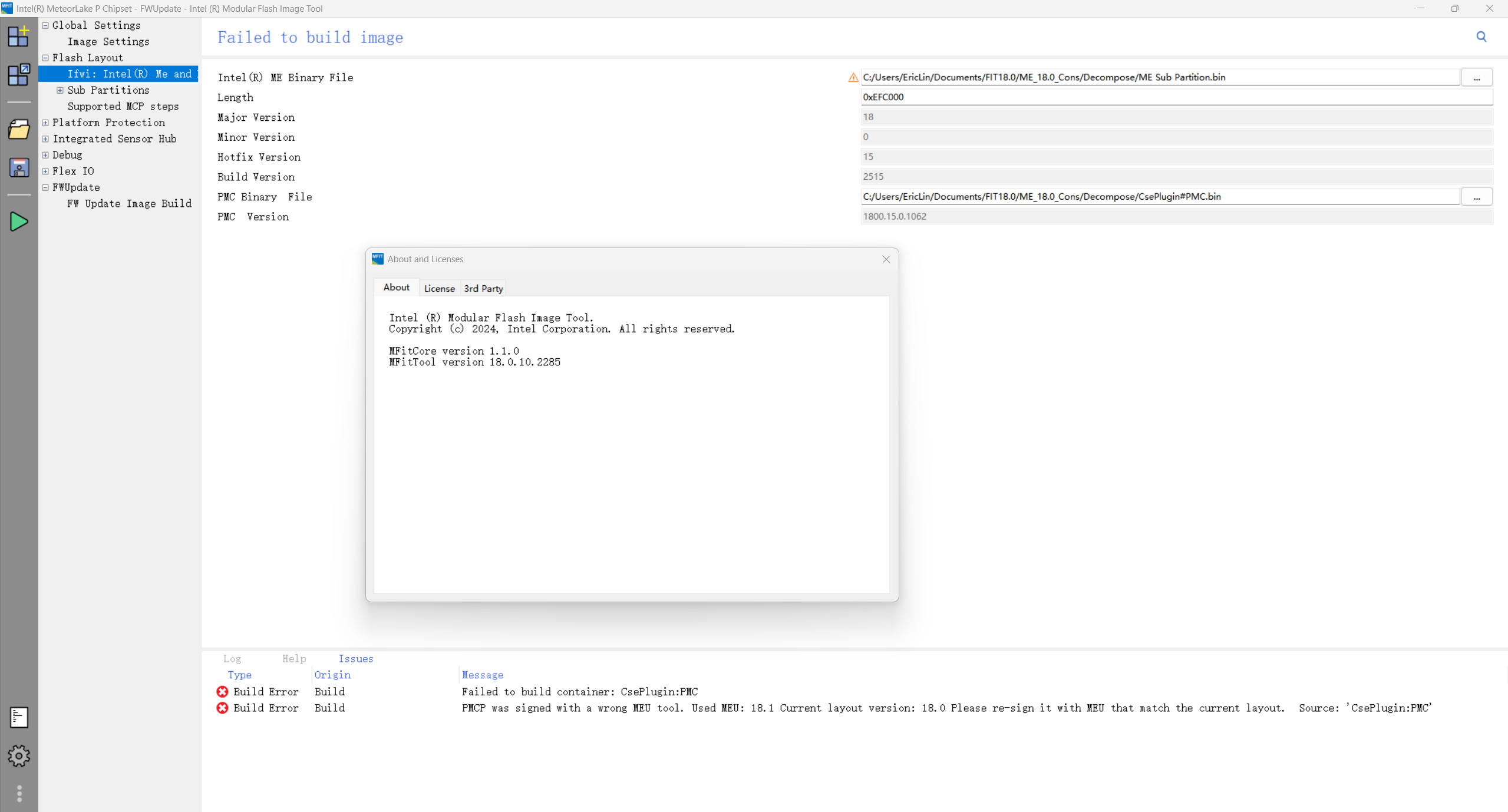

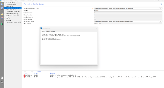

Does anyone have mFIT tool v18.1? I can’t rebuild the lateset CSME 18.0 Firmware
Original firmware link: Link
Try replacing PMC fw with older one
After changing the old PMC fw, update image can be successfully built, but after flashing the image via FWUpdate, it breaks fTPM (Intel PTT). Even worse, I can’t downgrade the firmware via FWUpdate, so is there any way to downgrade ME firmware?
