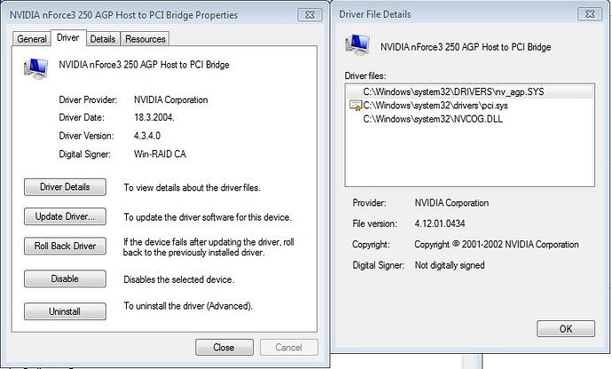

@Fernando Could you please digitally sign the 64-bit GART driver in your “Fernandos Special 64bit nForce3-4 LEGACY Driverpack for Win7-10 x64 v10.6” driverpack?
Only “nv_agp.cat” has a digital signature. “nv_agp.sys” and “nvcog.dll” need Win-RAID CA signature as well, in order for the GART driver to be able to work without Windows 7 being in the test mode. Could you please give the certificate to these two files as well?
You can see for yourself on the screenshot that “Digital Signatures” tab is missing:

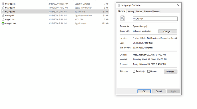

Unfortunately I am not able to send you the requested driver. The digital signature of a driver is usually layed down within the associated *.cat file and is valid for all *.dll and *.sys files, which belong to the driverpack. The signature is only readable by doing a right-click onto the associated *.cat file and choosing the option “Properties” > “Digital Signature”.
Attached is the 64bit NVIDIA nForce GART driver v4.3.4 with all associated files, which has just been freshly digitally signed by me.
freshly signed 64bit NVIDIA GART driver v4.3.4.rar (92.2 KB)
As you can verify yourself, the details of my digital signature can only be seen for the *.cat file.
By the way - not even the *.sys and *.dll files of the original and WHQL signed NVIDIA nForce GART driver v4.3.4 have an own digital signature.

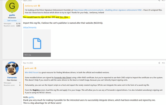

Tip: The Win-Raid CA Certificate itself can be imported by using NTLite. Look >here<.

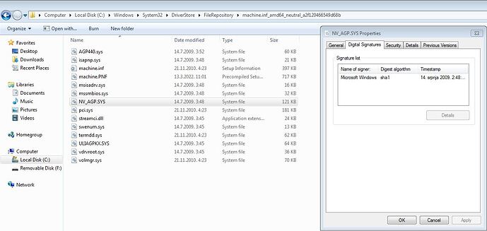

Look at the Microsoft Windows 7 x64 nForce3 GART driver that comes as a default after Windows 7 installation, it definitely has a digital signature:
And this is what I have after I install your signed driver:
So, the driver package as a whole has a digital signature, but the files “nv_agp.sys” and “nvcog.dll” don’t. The end result is that Windows needs to be in test mode in order to use the driver.

All files, which are required for a proper function of a driver, are listed within the textfile named *.inf. The *.cat file contains the information about the digital signature of all driver files. If any of them will be modified thereafter, the signature of the complete driverpack is broken.
OK, thanks for your help. But, just for the info: I haven’t modified any of the files from your latest signed driver, nor from the “Special 64bit nForce3-4 LEGACY Driverpack for Win7-10 x64 v10.6”.

Even there at NTLite forum it is said that all *.dll and *.sys driver files have to be signed.

@Fernando I believe I found what is causing the problem with the digital signature of the GART driver in Windows 7 x64. It is the SHA256 encryption.
Last week I tried numerous times on two different nForce3 motherboards to get the GART driver recognized as signed, but I haven’t succeeded. Here is what I tried: Windows 7 x64 SP1 was first freshly installed on both systems, Win RAID-CA digital certificate was then successfully imported and then I tried to install the driver with Digital Signature Enforcement enabled. It didn’t work. Every time on boot I had to press F8 and disable Digital Signature Enforcement and then the driver worked flawlessly.
Then I installed all Windows 7 x64 updates up to 2024 (including all updates needed for SHA256 patch for windows 7 x64) and it still didn’t work. I googled a lot about this issue (signing Windows 7 drivers with SHA256 algorithm) and indeed there are reports on different forums that it sometimes simply doesn’t work, like in my case.
So, in conclusion, do you still maybe have older LEGACY Driverpack for Win7-10 x64 prior to v10.6 that is digitally signed with SHA1? And if you don’t, could you please give it one more try and sign the GART driver with SHA1? The driver itself works great, it would be a shame to leave it like this…
