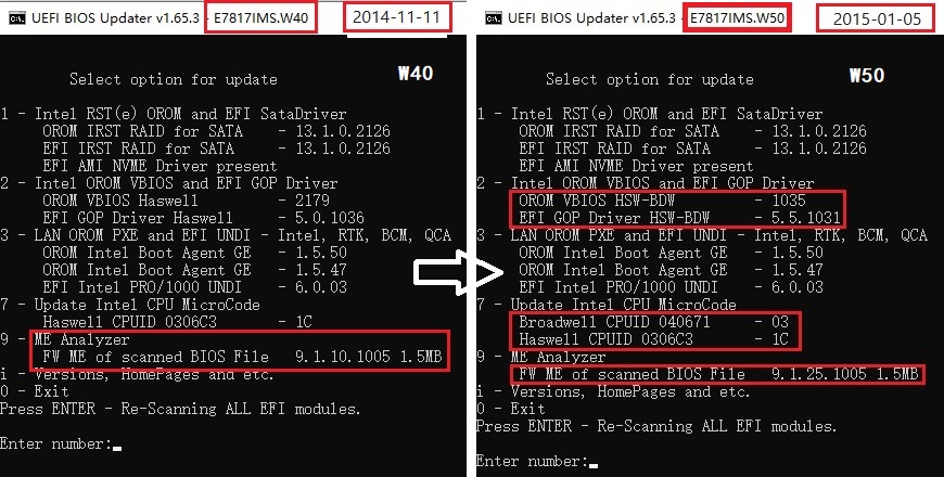

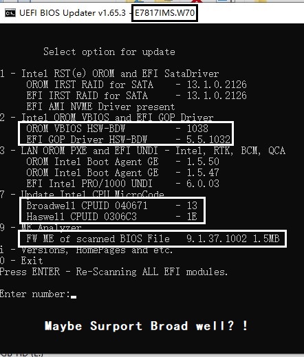

my z87 use z97 bios success run
only change me
me version 9.1.0.1015
bro u know about mrc?
use z87 bios debug code is 55
about memory so i think if change all about memory init z87 can use 5775c
