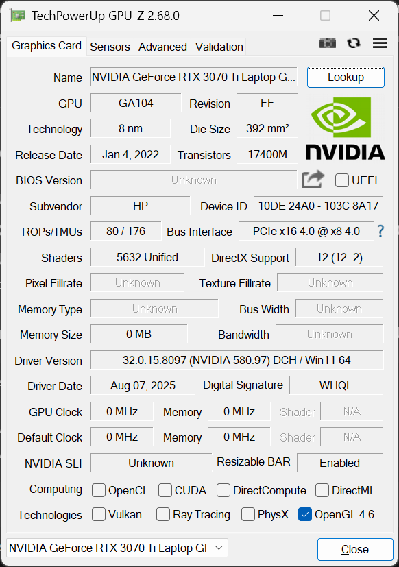

So I was looking for other methods to fix it and came across a video on youtube that showed how to flash the BIOS of the GPU, it looked easy, but I couldn’t find the BIOS on techpowerup.com, I found one for a Zephyrus G15 2022 and another for the ROG Flow X16 that are for the RTX 3070 Ti Mobile 8 GB. And on GPU-Z, BIOS Version it says "Unknown” so there is no way to check if that .rom file could work.
I want to know if by flashing the BIOS with NVIDIA NVFlash could help me revive it? And if someone could send me the .rom file for this hp laptop (at least I could try)?
Any other advice is welcome, thanks!
Here’s a screenshot of what gpu z shows

I have that same exact laptop with it fully working. Do you need the vbios from mine?
That would be amazing! Thanks!
I tried sending it to the Techpowerup database, but they said they already had the vbios. Here is the one that they have on there now.
The vbios posted in that link apparently was the same exact one as on my current laptop.
Great! Strange that when I tried searching it up on techpowerup, it said that there were no VBIOS for that HP, but well, I’ll try flashing it with that one. Thanks!
