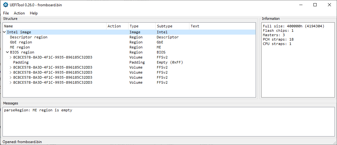

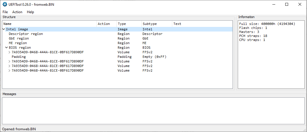

further specification: I tried another psu and cpu and without changes. The board is only blinking (p-led), not beeping. Processor is normally heated - the temperature gradually increases. Fan speed is constant, but quite low - when I connect the cooler to system fan header, the speed is much higher. I opened both .bin BIOS ( “backup” and the downloaded from the web) in uefitool and i´m attaching screenshots. For backed up bios uefitool reports: “parseRegion: ME region is empty”, the second one doesn´t report any error but doesn´t make the board alive…
