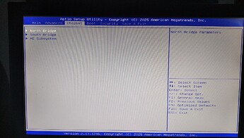

Can you just flash this BIOS from Angxun X79-VG4 to see if it boots up? It could be that I misconfigured the ME in Intel FITc somehow.
ANX_X79-VG4_210825.zip (3.3 MB)
I’m programming it now, I’ll let you know.
It gave me an image, let me try it on Windows.

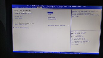

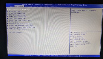

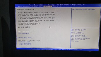

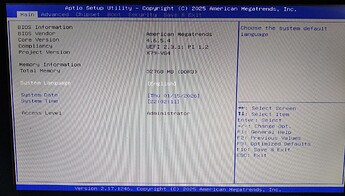

First thing, I’m glad the BIOS works for you. Are there any glitches / strange behaviors? Would you mind uploading some screenshots of the BIOS, just for validation only?
Moving onto your question: I don’t play COD: Warzone personally but a quick look at the requirements shows that the games requires TPM2.0 and Secure Boot. For Secure Boot, you just need to disable CSM and turn it on in the BIOS, but for TPM2.0, you might need to connect an external module through the DEBUG header. A guide for that is already present on this forum.
Side note: Resizable BAR is included by default, and you can enable that (and Above 4G Decoding) in the PCI Subsystem Settings menu for a bit more performance.

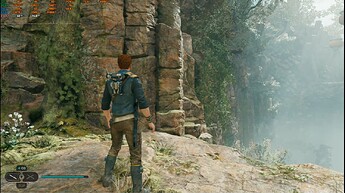

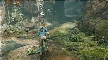

I played Jedi Survivor for a while without any problems, but after two and a half hours, I noticed that the GPU usage got stuck at 100%. The FPS remained the same as when this problem occurred. I opened other games, and the same thing happened. It was only fixed by restarting. I also noticed that the AMD software was closing on its own.
I also noticed that the second time I turned on the PC after installing the BIOS, a message about PCI bus or something like that appeared in the notifications, recommending a restart. That notification didn’t appear again.
I also have rebar + 4G enabled and Secure Boot activated. I hadn’t had this problem before with my original BIOS.
I don’t know if it’s something with the BIOS or my RX 9060 XT GPU configuration with undervolt -90 and -15 power limit.
Problems like freezes, restarts, blue screens, or the computer shutting down on its own haven’t occurred.

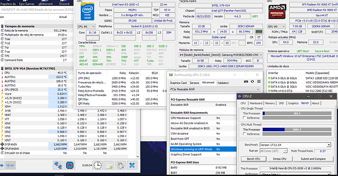

Is my processor performing okay?

  • 100% GPU usage = Congratulations, the CPU you currently have can in some situations max out the GPU (=the GPU is not bottlenecked by the CPU). I am not surprised that you started seeing this after getting more modern features like Rebar.
  • Message from AMD drivers that it wants to restart=Normal when Rebar changes state
  • The undervolt on your GPU might be a bit low, which may be the root cause of problems you see
