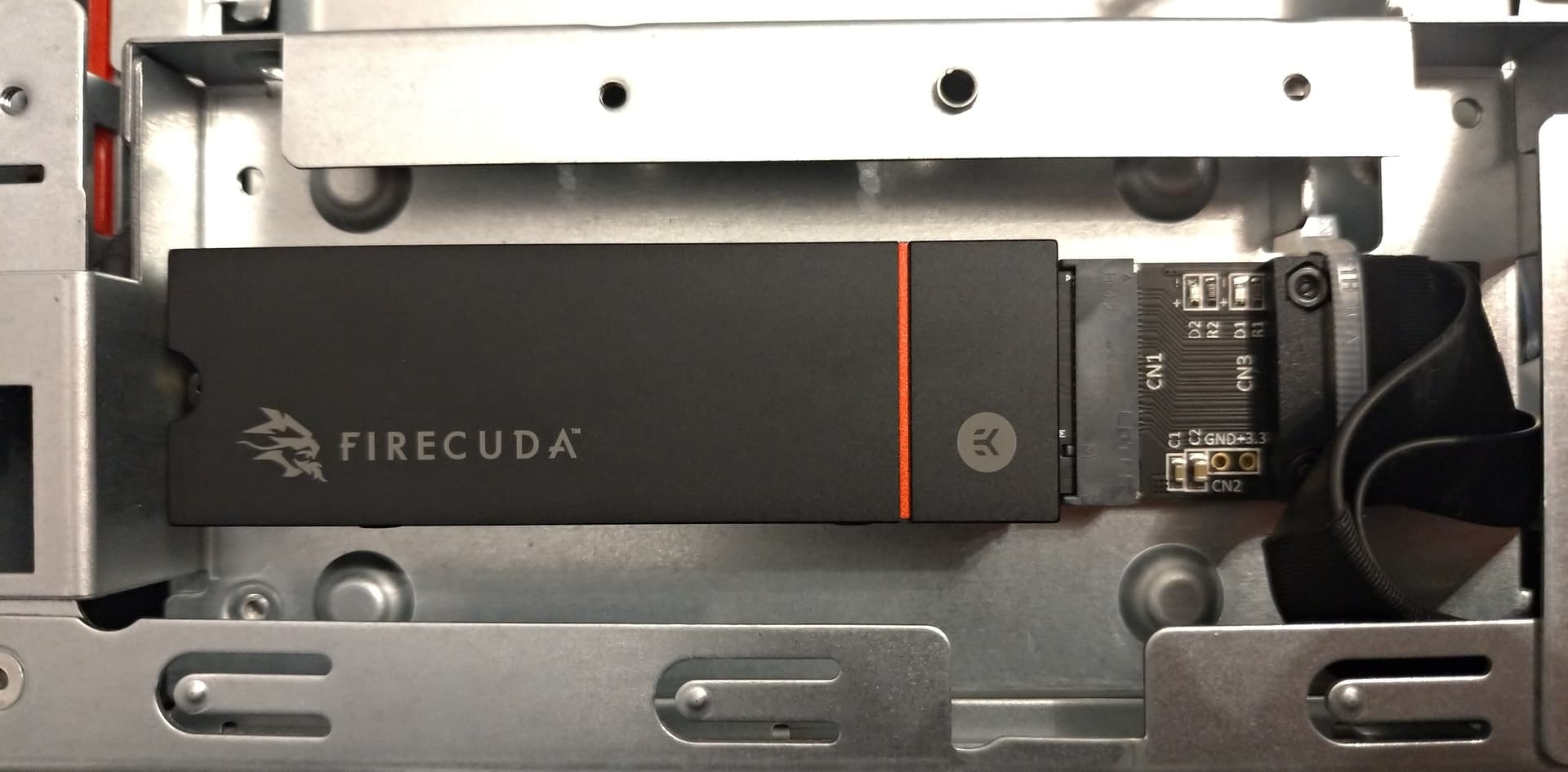

About the m.2 SSD, I have another piece of advice. On the G20CB (and G20CI), the m.2 slot is located next to the core voltage regulators, which get quite hot. This means that the SSD, when installed there, operates in a rather hot environment and can easily reach a critical temperature (which leads to throttling, throughput decreases significantly).
In case you no longer need the 2.5" slot (in which a SATA SSD is installed usually), there is an elegant solution. You can simply relocate the m.2 slot upwards using an m.2 riser cable (I used a Delock 64136 + double-sided tape and a cable tie). The additional space allows to use a heatsink and another advantage is that it is much easier to access.
