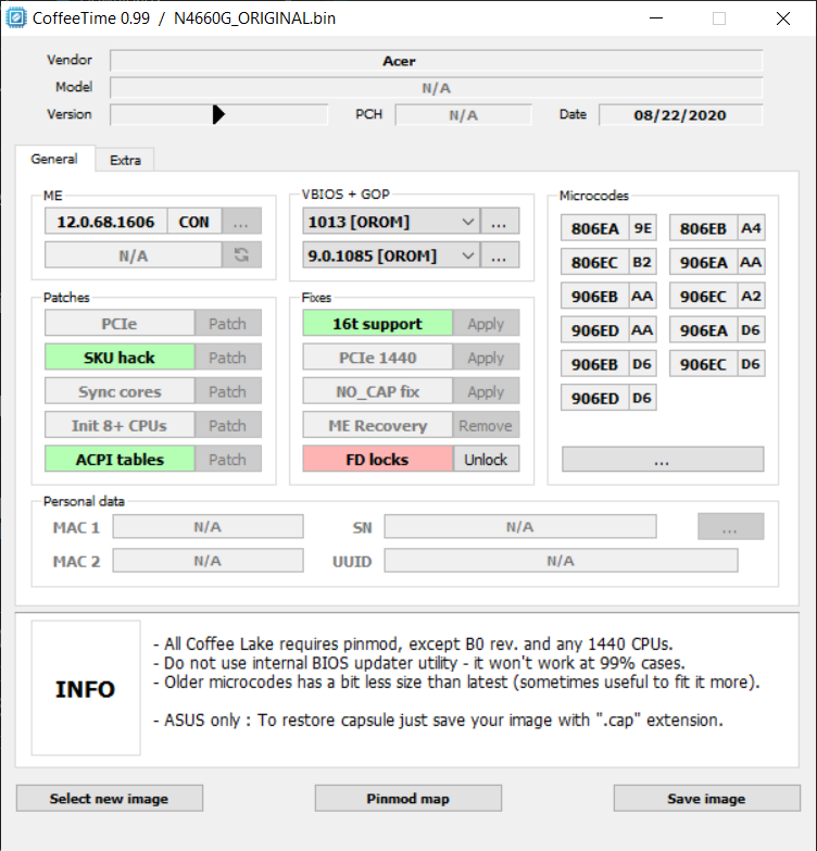

Hello,
I’ve modded several 100/200 chipset boards, with and without pin mod to enable coffeelake chips, skylake/kabylake xeons, and now i’m running into the issue where i can’t mod this b360 acer board to switch consumer to corporate ME version to enable xeon support. I’ve attached the bios dump (read with ezp2010). This is what i see with the coffeetime tool, it can’t do much to this bios file.
I’ve also tried new engine UEFITOOL (replace option disabled), old engine UEFITOOL (supposedly lets me edit me regions but crashes on file load - tried several versions), intel FIT, me_cleaner, nothing had anything helpful for me so far. Any help is appreciated, thanks!

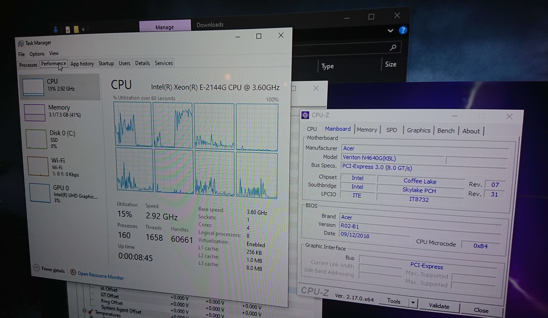

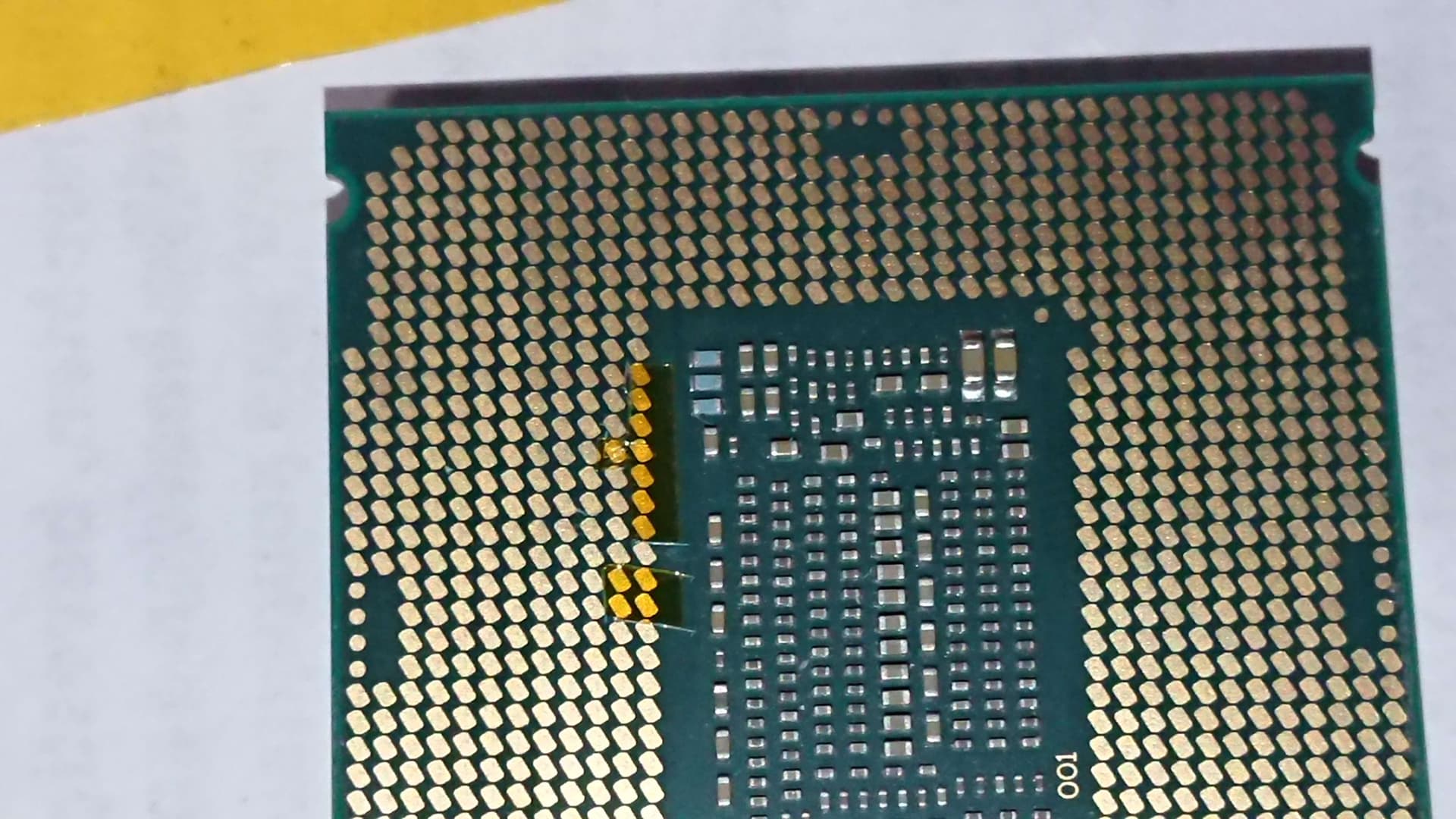

as a therapeutic/revenge against intel measure, i did the pin mod and placed it into a modded bios veriton N4640G
