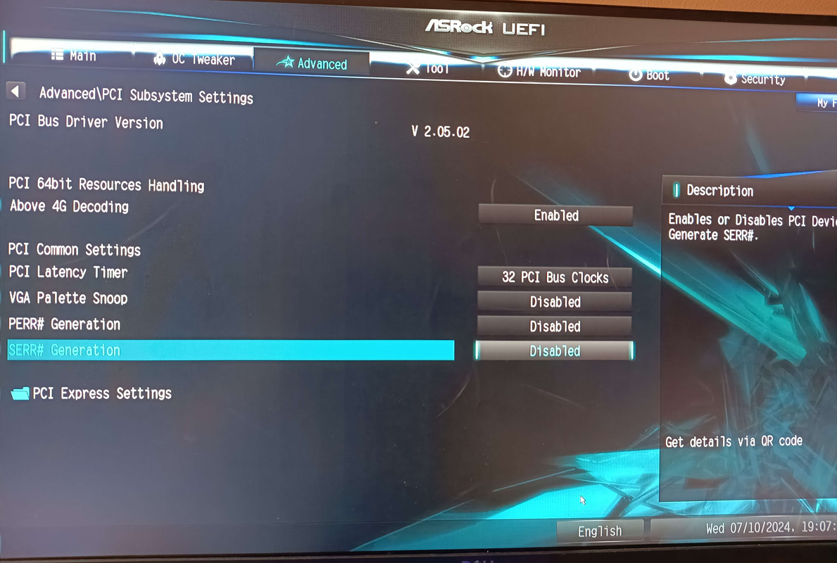

In bios i cant find anywhere where is 4G to enable

Are you sure you did flash this exact bios, not any previous bios i posted here? Because i thought PCI Subsystem Settings would appear in Advanced options, not in any Advanced sub menu, directly on Advanced menu and PCI Subsystem Settings Sub menu.
As for the gpu, what is your gpu? Maybe send a gpuz screenshot for it?

I saw it last night when I got home. That’s right. I activated 4G from there and was able to give unlimited. bios — Postimages
We also saw some new settings in bios. What settings u recommand to enable/disable for pcie?

I would leave it as is, since i only make those options appear, so feel free to experiment.
