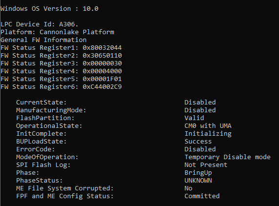

This is what MEInfo gives me on the “modded” PC.
I think CS(ME) is not corrupt, but I might need to use a different version to make it work?
I’ve ran MEInfo with the original bios, it showed that PTT is enabled, but the PTT initialized at start-up was set to disabled, could that be causing the Trusted Computing sub-menu to not be available?

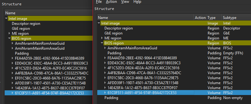

I downloaded the original bios from fujitsu (V5.0.0.13 - R1.38.0 (22/10/2024)), there was a D3601-A1x.R1.38.0.bup file, i used 7zip to extract it’s contents, and I got a D3601-A1.UPD file, but it’s size is around 28MB, while my flash is only 16MB.
I put D3601-A1.UPD into FIT and then I saved it from there, I got a 16MB bin file out of it and then I used CoffeeTime to manually add NIC MAC address and I disabled bios lock etc. in there.
I flashed that image but now the pc just spins the fan for 2 seconds and shuts down.
I’ll try to shoot them a message, thank you for the link.
Your mixing things up… and yes, the FSC .bup files are not ready ones to use in CH341A… take a break and read more, most of these files are updates of regions and need to be combined/swap with the original dumps that are “expanded” images with readable regions, like the original dump.
Besides it looks a “regular” image its not and must be cut.
Select block top to 0x1000000, resulting in 16384k
Now, by using this method, all the board system data must be transferred.
Not sure where this is but, looks like the 1rst pad and 2nd NVram volume should be considered.
