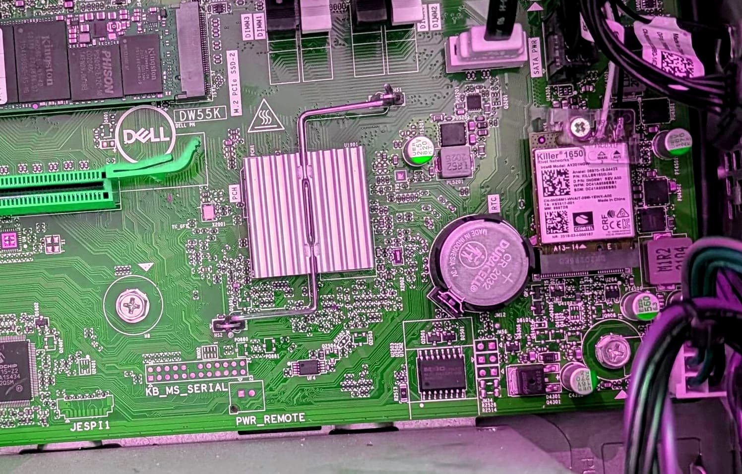

@ismailTPC_Hastanesi , I’ve seen Dell install this flat pins manual bridging before, but they usually do it on laptops. I have an old XPS laptop where you can manually bridge like you’re considering, so we might be right in this case, given the flat pins location.
You really need a schematic for this board, and I found it on a forum. Not sure what you have to do to accumulate needed forum points to actually download it, but it looks promising.
The image below is one shared by Dell itself regarding the PSWD jumper.
If you look closely, it bears a strong resemblance to @Marcus1’s motherboard; however, his motherboard lacks these pins—only the contact points on the circuit board are visible.
Yep. We’re definitely on the same page. I’m 95% sure Dell went cheap by a few cents, and didn’t do their standard elongated pins with a blue jumper, but that those pins are a good bridging focus.
It may cost him a little money to buy points on that forum to download the schematic, but it’s probably worth it in this case (although there are no guarantees). That schematic should answer the question, and then it’s about execution.
I would think that you need some type of adhesive (putty?) to temporarily bridge on reboot, using some type of thin wiring? Just shaking my head at Dell going so cheap on this; they should blue jumper this (and laptops, for that matter!).
@marcus1 , I’d pay the $ to download the schematic. It’s probably worth the peace of mind, and if you can execute it, it will be a better solution that trying to grip that damn 16 pin bios chip. I’ve done it, and it’s not fun.

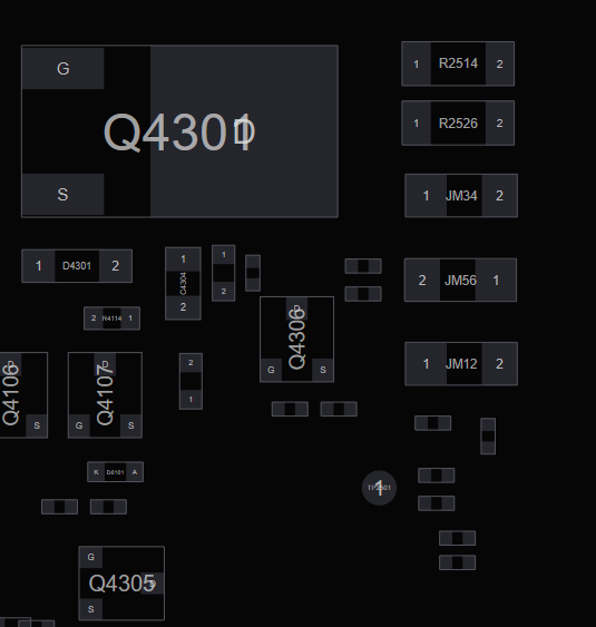

Hello all, thank you for your patience. Here is the .cad file: https://drive.google.com/file/d/1mHKhAt43tGcatdu_Ywo3nh-fqSTELkx2/
I tried bridging those flat pins again with no luck but the SOP-16 clip arrived so I’ll be trying that next.
Sorry @marcus1 , but that’s not the file I was hoping was attached in that forum. You can open it with the Nexus BoardViewer, but it’s not a full developer schematic. The jumper numbering convention is the same that MeatWar found on the other/newer boards. You can keep digging. If those are the right pins, I’d be tempted to consider installing elongated pins for ME disablement, but that would be another chore.
