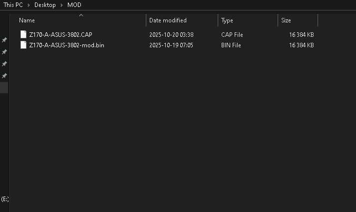

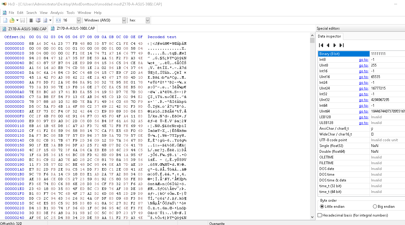

Do you mean that 0x800 = all code between 0>800 copy and paste to the .bin file? I tried it but didn’t seem to change filesize.
Thank you for your time.
Okay so I copied all the 0x800 code from the og asus cap and did “paste write” on the modded .bin file and saved it as .CAP but still no file size change, what am I missing?
Same size even after copying the 0x800 :E
Dont know… you know that the copy block data is to ADD to the top of the mod file right???

That did the trick with the filesize, I added the 0x800 instead of copying and pasting it! After flashing with AISuite it rebooted in to the bios this time and completed the installation in the EZFlash suite, but still no PCH-FW in bios, cleared cmos after the install as instructed but nothing.. No I do not but it’s either this or buying a completely new system due to faceit anticheat forcing me to run TPM 2.0 haha, I guess i’ll figure it out and it can’t be more complicated than this I presume, got the bios on my laptop and USB ready just in case.

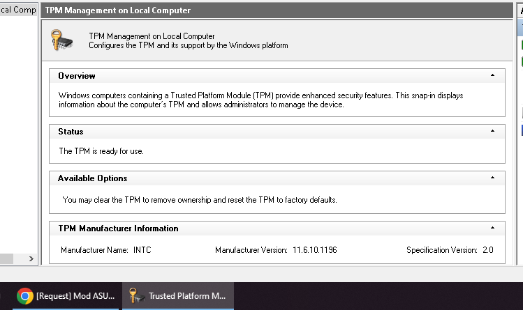

I meant overall not from you guys this is a deeper subject than I thought haha, and I actually managed to activate TPM after many tries!
I followed the guide on reddit once again but with a fresh mindset and figured out that the mistake I made earlier was formatting the USB drive via Rufus with Grub 2.1.2 instead of >Grub4DOS 0.4.6a< which allowed me to execute “setup_var 0x6A6” etc. commands without any hassle and now I’m sitting with fully functioning TPM 2.0, earlier I got way too focused on the previous steps and not realizing I was already at the finish line!

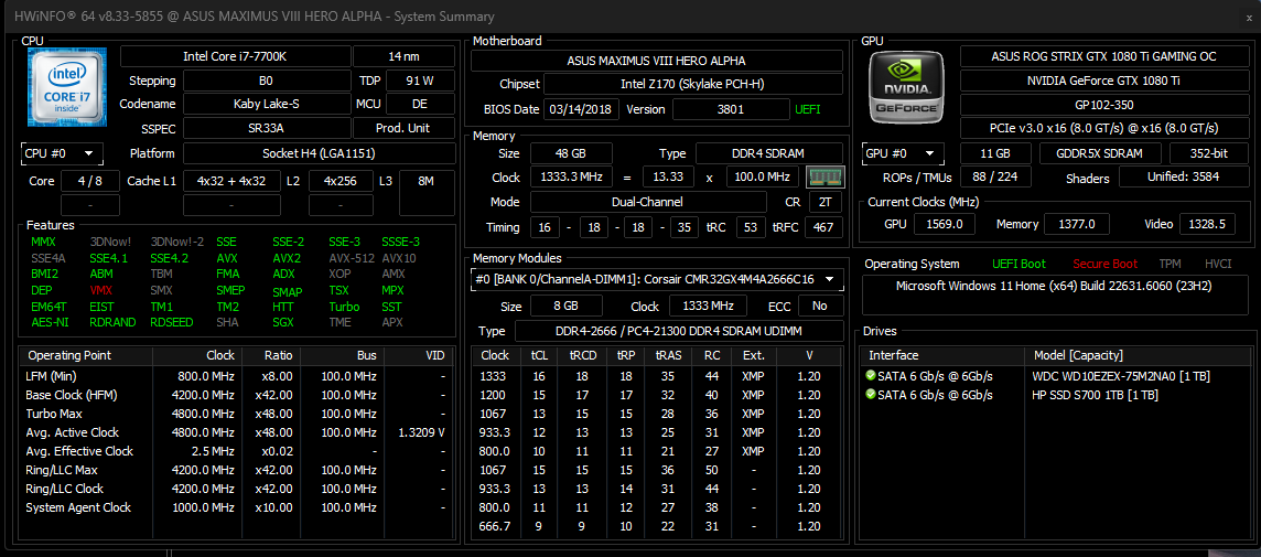

It is in my Screenshot, sorry forgot to type it.
- Asus Maximus VIII Hero Alpha with a Chipset Intel Z170 (Skylake PCH-H) running the latest 3801 BIOS version
- I7-7700k (Kaby Lake-S, Socket H4 (LGA1151)
