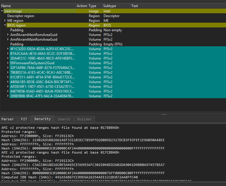

AMIBCP v4/v5 is an old leaked tool witch versions are from the times of Aptio IV and not valid anymore for MOST of modern Aptio V core bios.
Current leaked versions can’t deal with the correct modifications as its needs to deal with other bios modules/guids
The best approach is the UEFI editor not to confuse with UEFITool and none related with Intel FIT (Flash Image Tool) and his purpose.
I just tried the UEFI editor tool and it does exactly the same thing to me as with AMIBCP, my PC starts in a loop…
I think you have to disable Boot Guard, right ? But I don’t know if it’s possible ?
Well… usually this happens when users just “Unlock”/mess with variables they dont know and/or one setting messes with other functions, you should work also, only in an FPT bios region dump with all security disable… we dont even know if this is a bad flash, a bad mod or even how you’re applying the mod file to the system… kind of a “blind” answer when we dont know user actions, his experience, etc…if i make myself clear enough… not saying that its entirely your fault…
One thing is for sure, UEFI editor will deal better with mods on you A25 bios from 2023 than old AMIBCP…
Go for small steps…
How to disable all protections ? because I only disabled a few with GRUB but I don’t even know if the changes were taken into consideration…
Not all can be disable and some areas that are boot guard protected usually when touched…you get what you already know…
Changes by GRUB can be reckecked upon reboot, again with GRUB, not a cold boot as you probably know…
These areas can be seen here in UEFITool colored… as you can see most of bios region is protected and not a good bios for mod results… even worst in OEM branded systems, some users have achieved some small modifications with success…it all depends on your “time” and “persistence”, who knows you may get it after all.
God luck and you should wait for other users POV.
EDIT:
Im sure you understood the part of Boot Guard protected areas…
and no confirmation or denial part seems quite explicit.
so I will never be able to modify anything in the setup because it is a colored part?
like for example the XMP profile 1 option or the BCLK configuration which are both in the setup which are therefore in the colored part I will not be able to modify them?
