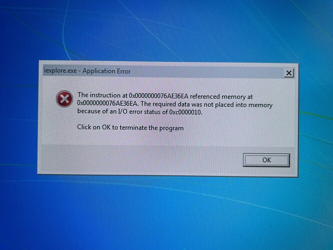

What driver version are you using? I tried with the version 475.14, and the driver just appear to be missing into this driver version, also at the same time like it’s probably also driver related, i have a problem with my computer which is when the computer go in sleep mode and resume, it’s crash, like by example it’s immediately restart, or i’m able to logon but it’s crash after, or it’s just show an error like this one, i think it’s probably a acpi wake alarm issue or intel management engine issue so i wanted to know if you maybe have a fix, because my pc can work without the usb-c drivers, but this issue is bigger for me. And at the same time i don’t know if it’s related or not, but the trackpad isn’t working, the driver doesn’t appear in the device manager, and doesn’t appear in the unknow drivers list. Thanks you

I have some updates, i successfully fixed my sleep issue by replacing the ssd, i searched again for the 2 missing drivers, i didn’t find anything but well my pc work perfectly without these drivers, but yeah for the trackpad, i didn’t find anything. So the biggest problem for now is the trackpad and the minor issue with the 2 missing drivers.
