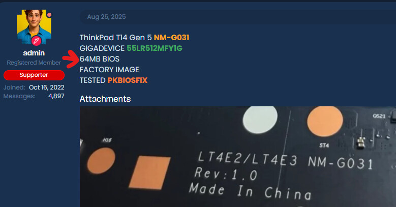

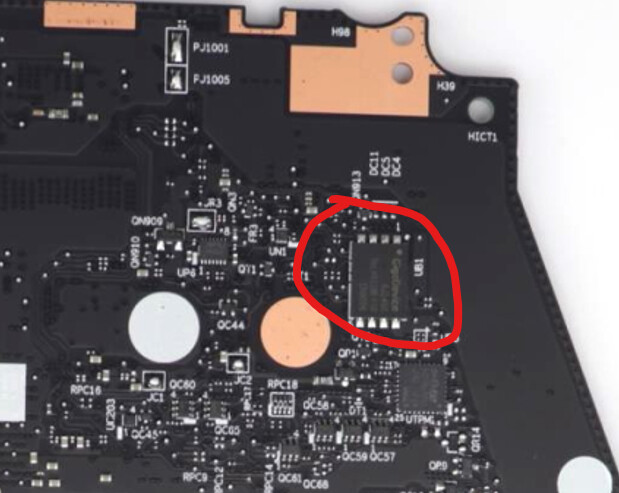

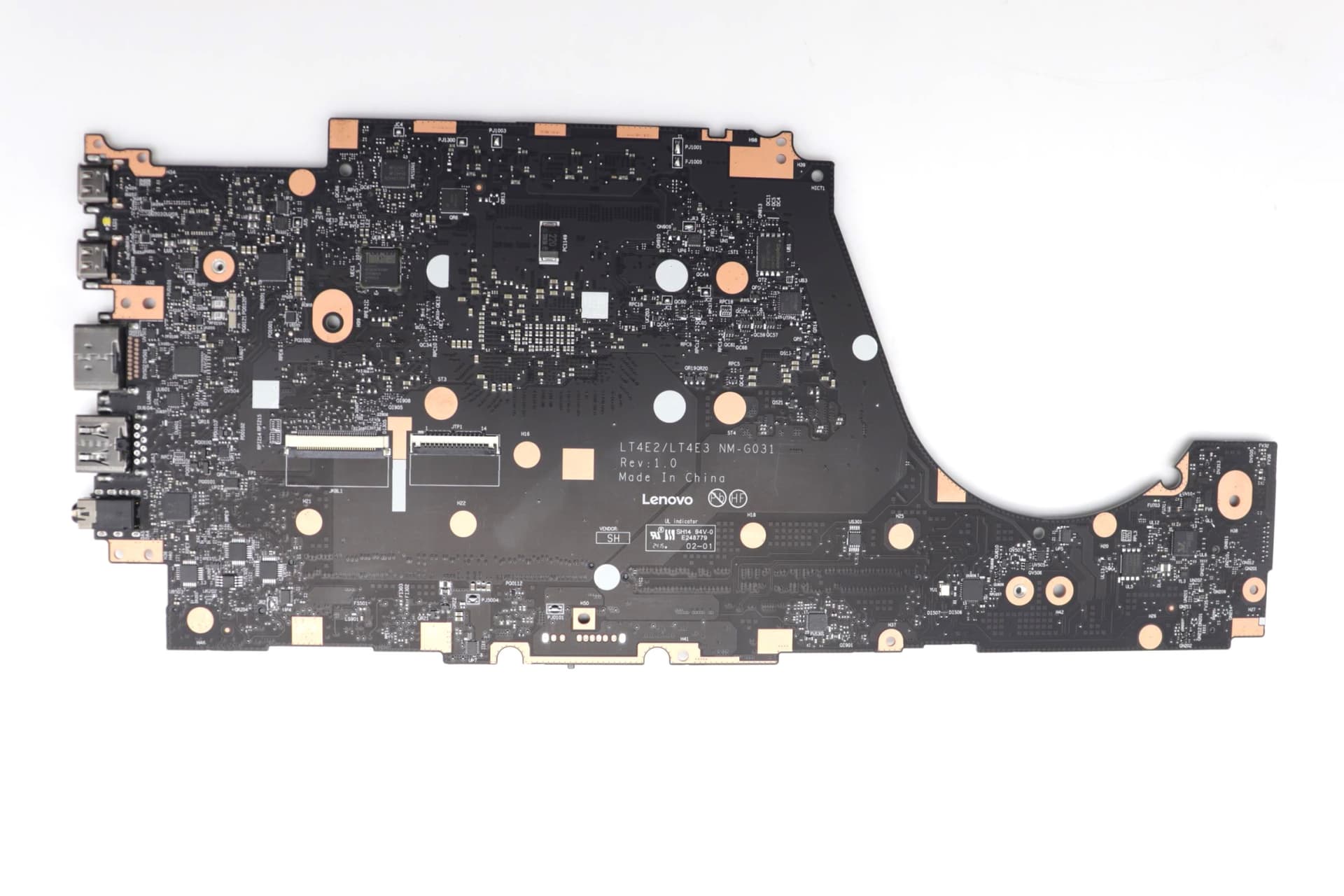

Is NM-G031 the motherboard board number? However, this information does not come from the laptop I own, but was obtained from the motherboard images in the component information for the 21ME model series on Lenovo’s official website.
Yes it’s correct… when dealing with such operations, the visual inspection is a MUST.

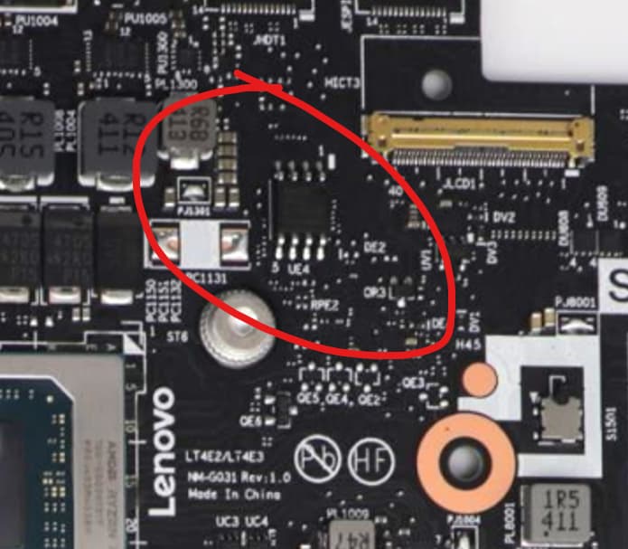

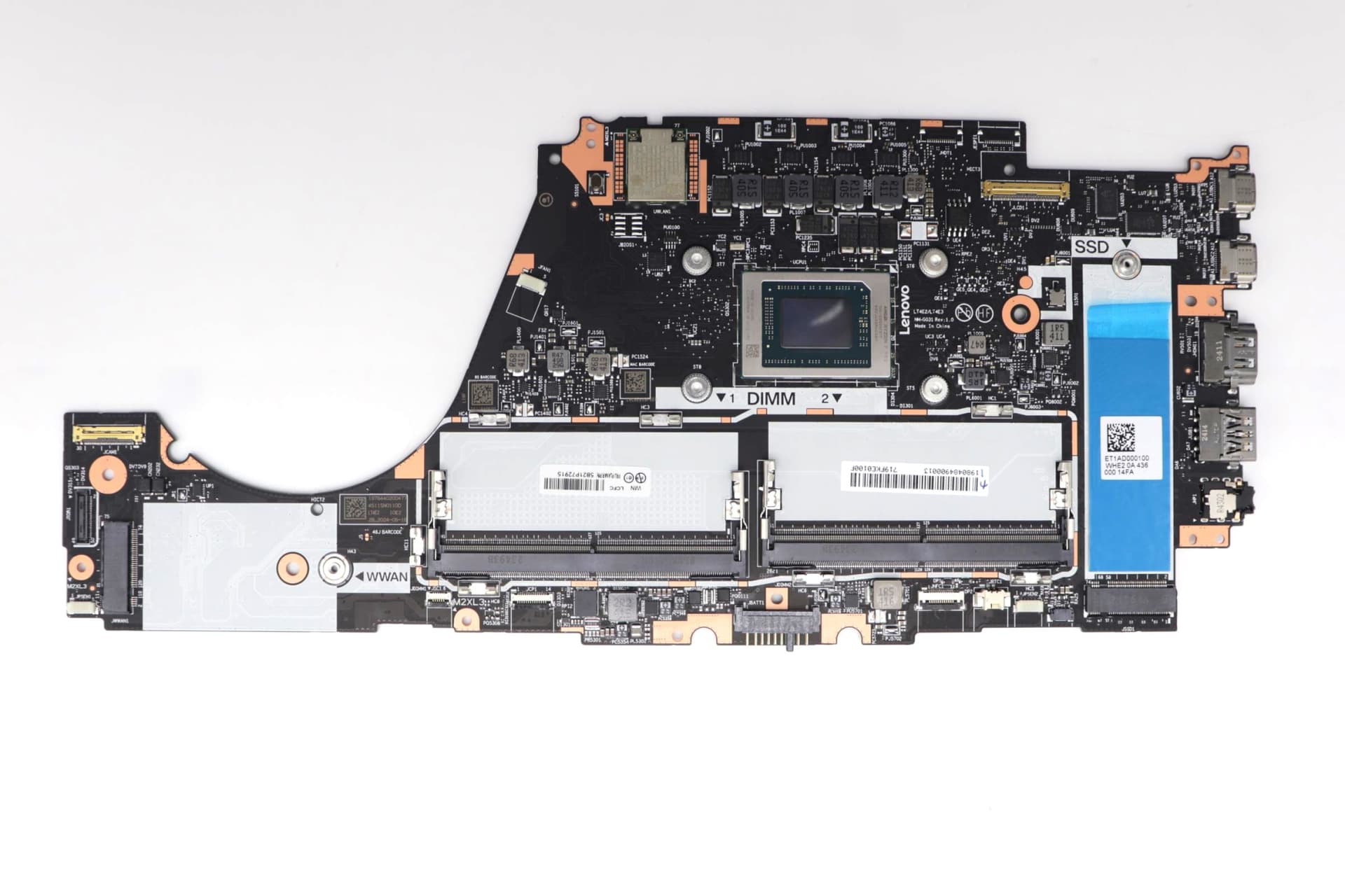

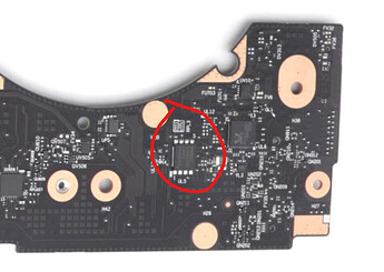

Lenovo file after extraction is 64Mb… i dont have the schematic/boardview of the NM-G031 to confirm the ICs of this motherboard… but i would expect something like at least 32Mb dump, so you dumped incorrectly, dumped wrong IC or the board has multiple ICs
Possible reading ICs
Yes, the file I currently dumped comes from the 25LB128ESIG chip, with a file size of 16MB. Are the other chips located on the opposite side? This task requires a significant amount of free time to complete, which I currently don’t have. Thank you very much for your response.
