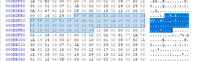

So finally, the correct struct will be like this ?
# Type  Size    String ID   String ID   Question ID                     Form ID     Question Id    Form GUID
#               of name     of desc
# 0F    0F      BE 1A       E5 1A       02 00       00 00 FF FF 00      03  E1      29 02          0A8212861A000000120619000000160212061600010016022902198212860D000300
# 0F    21      BE 1A       E5 1A       02 00       00 00 FF FF 00      99  00      01 00          9E76D4C6487F2A4D98E987ADCCF35CCC290229022902290229022902290229022902
# 0F    21      BE 1A       E5 1A       02 00       00 00 FF FF 00      01  00      01 D2          4CFD01432B8145B9CD380EDEEF508129022902290229022902290229022902290200

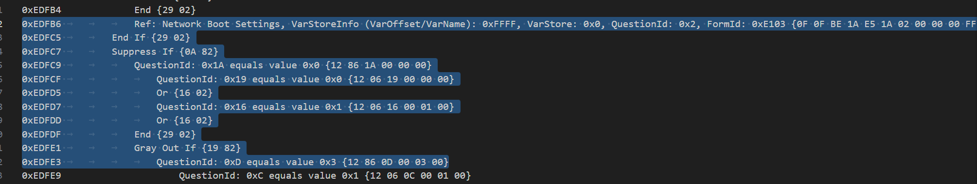

EDIT: I did a try with this config:
Op Patch
Pattern
0F0FBE1AE51A02000000FFFF0003E129020A8212861A000000120619000000160212061600010016022902198212860D000300
0F21BE1AE51A02000000FFFF00010001D24CFD01432B8145B9CD380EDEEF508129022902290229022902290229022902290200
The BIOS crashed when i clicked the General Settings, the parent menu of the Network Boot Settings lol
EDIT: Another try with:
Op Patch
Pattern
0F21BE1AE51A02000000FFFF0099000100D24CFD01432B8145B9CD380EDEEF5081290229022902290229022902290229022902
Somehow its still crash when i click the Network Boot Settings.
#               of name     of desc
# 0F    21      BE 1A       E5 1A       02 00       00 00 FF FF 00      01 00      01 00           D24CFD01432B8145B9CD380EDEEF5081290229022902290229022902290229022902
# 0F    21      BE 1A       E5 1A       02 00       00 00 FF FF 00      99 00      01 00           D24CFD01432B8145B9CD380EDEEF5081290229022902290229022902290229022902

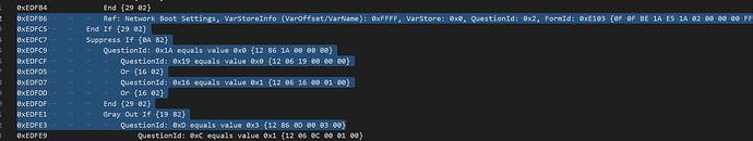

EDIT: Finally, Thank you ! I’ve understanded how to modify it correctly, By this:
Op Patch
Pattern
0F21BE1AE51A02000000FFFF0001000100D24CFD01432B8145B9CD380EDEEF5081290229022902290229022902290229022902
The Network Boot Settings will open the menu of Performance Tunning.
Again, Thank you !

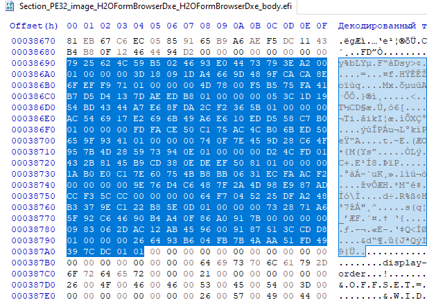

And btw, Do you know how to extract H2OFormBrowserDxe data, its all of string piece in non-hex mode. Someone says some menu were hidden inside H2OFormBrowserDxe, I want to check out by my self.

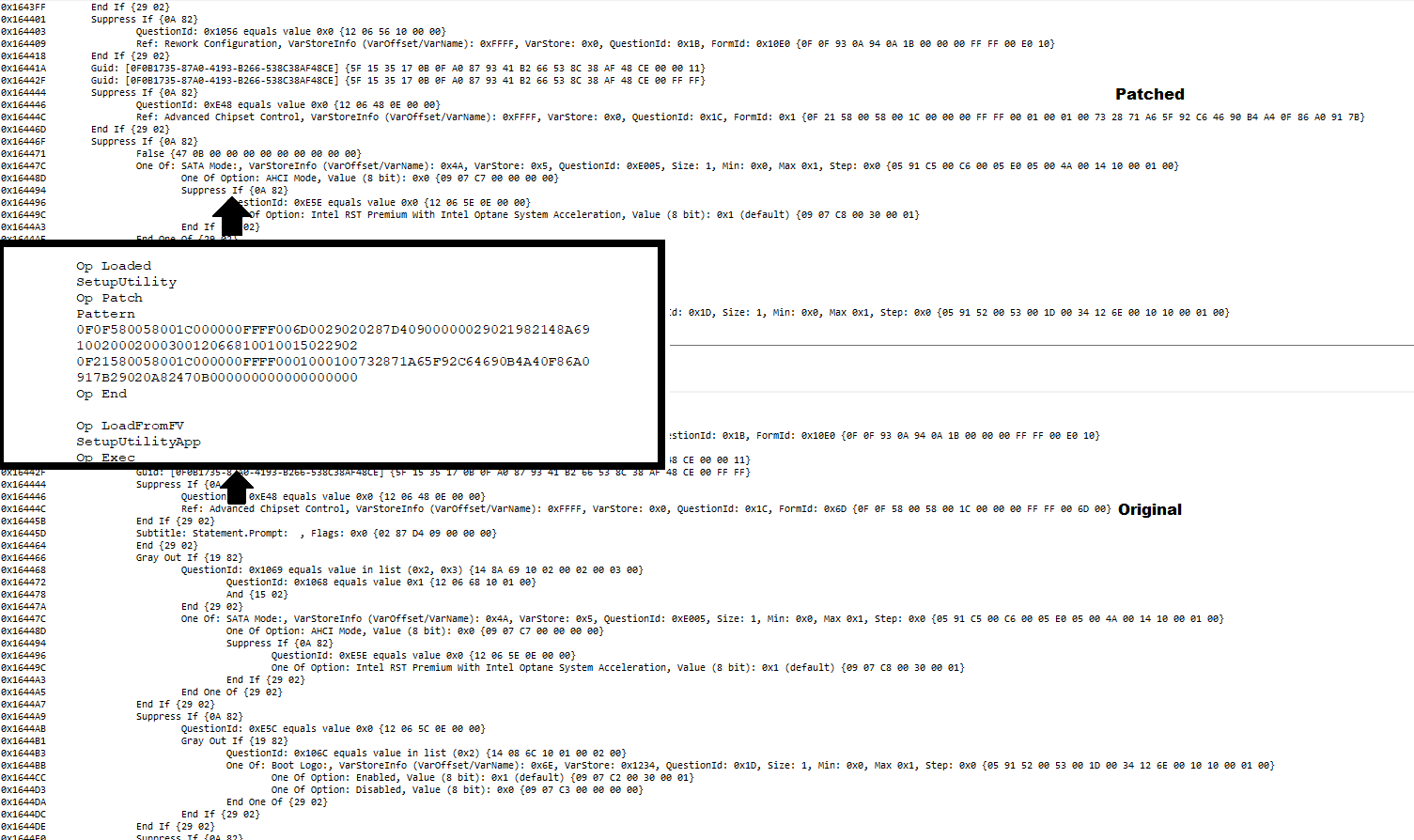

I mean the following
Advanced Chipset Control refs to form 0x1 in Power tab. Basically, this is the same as what you did.
There’s no IFR data in this module. You can’t extraxt what doesn’t exist.
Perhaps, you're looking for this array

Yes, I don’t know if this array defines if the menu should be appear, By my search on internet it should be, But how them got the menu name ?
Which means if advanced was deleted, There is no way to adjust CPU, unlock configs ?
It does define which formset should appear. See SREP-Patches/Configs/Acer/Lenovo Metro Display Engine_Insyde_BiosUnlock.cfg at master Ā· Maxinator500/SREP-Patches Ā· GitHub
The bios tab name gets retrieved from the formset ifr data.
