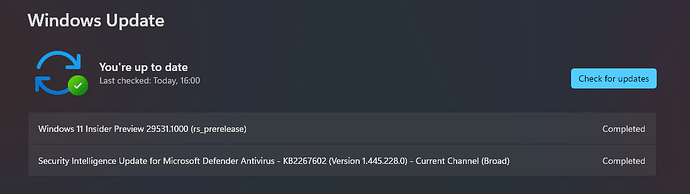

Someone from WinClub posted a screenshot showing that version 10.1.37.7 (for Alder Lake)
was detected, while my tool detects 10.1.37.5 from the 10.1.20404.8794 installer.
I’m guessing Microsoft added the newer version to the Windows Inbox Drivers
—the drivers built into Windows 11—or it was installed via Windows Update.
In short, my tool detected something newer than Intel officially lists on its website.

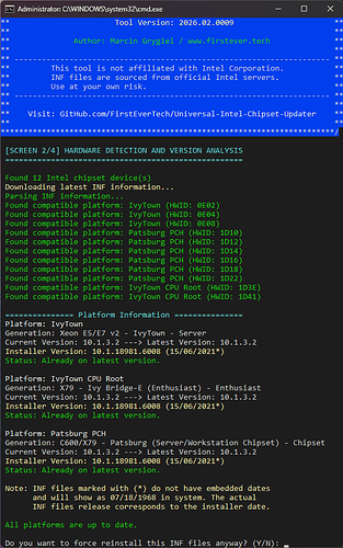

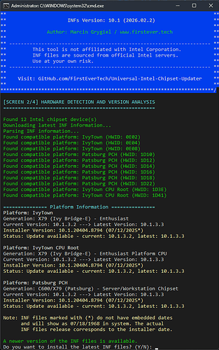

Detection…
Installation…
Voilà!
As you can see, Intel’s latest installer was installed successfully, despite containing no INF files applicable to my system. This is exactly why I created my own tool — to avoid installing Intel’s so-called chipset installer that performs no actual hardware configuration.

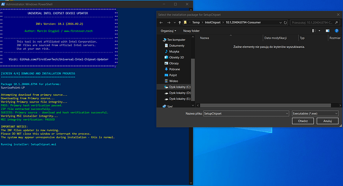

The problem is that during installation I want to install .msi and in the dialog box there is .exe. The installer is available in the temp folder but I can’t open it because it has the wrong extension.
just like in the picture
I’ve double-checked the script and the package, and there’s nothing wrong with either.
The issue is that Windows Installer on your system fails before initialization and falls back to searching for an executable, even though the MSI package itself is valid. This is a problem with your Windows configuration, not with the file itself.

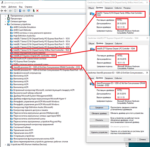

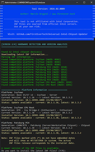

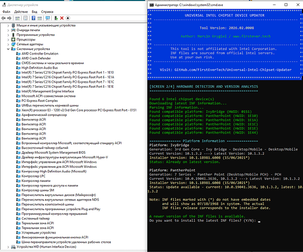

Hi @FirstEver
Thank you for the Universal Intel Chipset Device Updater program.
I have a few questions. When I run Universal Intel Chipset Device Updater, it doesn’t detect the following devices in my system:
And after installing chipset driver 10.1.18981.6008, the devices listed in the program are updated to version 10.1.3.2, with the exception of PCI\VEN_8086&DEV_1E44 (it doesn’t install).
If I try to update them manually:
  • PCI\VEN_8086&DEV_0150
  • PCI\VEN_8086&DEV_1E22
  • PCI\VEN_8086&DEV_1E44
    the update wizard reports that these are the current versions (and no update is required).
    BUT, Windows itself offers to update them and the devices (PCI\VEN_8086&DEV_0150; PCI\VEN_8086&DEV_1E22; PCI\VEN_8086&DEV_1E44) are updated to version 10.1.13
Question:
Why doesn’t the Universal Intel Chipset Device Updater see these devices?
Why aren’t they installed either through the chipset driver installation or manually, even though these VEN&DEV devices are listed?

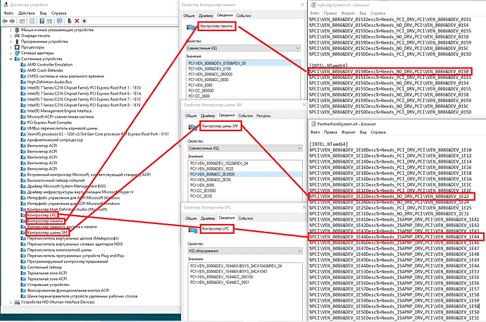

Thank you for your detailed report.
I have verified this thoroughly against the complete Intel Chipset INF archive used by the tool.
I checked all 93 official Intel chipset installers, containing 5,333 individual INF files, and none of them include the following hardware IDs:
What these devices are
All three devices belong to the Intel 7 Series / C216 (Panther Point) platform (Ivy Bridge generation):
  • DEV_1E22 – 7 Series/C216 SMBus Controller
  • DEV_1E44 – 7 Series/C216 PCI Express Root Port
  • DEV_0150 – Intel 82579LM Gigabit Network Connection
These devices are from a legacy platform that is no longer actively updated in current public Intel chipset packages.
Why the Updater does not detect them
The Universal Intel Chipset Device Updater only recognizes hardware IDs that are present in official Intel-distributed chipset INF packages.
Since none of the 93 Intel installers contain INF entries for these HWIDs, the tool correctly does not list them as supported or updatable.
Why Windows Update installs version 10.1.13
The 10.1.13.x drivers offered by Windows Update are Microsoft-distributed system drivers, not part of the publicly available Intel chipset installer packages.
Microsoft sometimes republishes or repackages Intel chipset INF components under its own update channel. These packages may:
  • Contain additional hardware IDs
  • Use extended or merged INF sets
  • Be digitally signed and distributed independently of Intel’s public releases
That is why:
  • Manual update via Intel installer reports “current version”
  • The Universal Intel Chipset Device Updater does not detect them
  • Windows Update still offers a newer 10.1.13.x system driver
Summary
There is no detection bug in the tool.
Those specific HWIDs simply do not exist in any official Intel chipset installer INF file. The versions you receive via Windows Update originate from Microsoft’s driver distribution channel, not from Intel’s published chipset packages.
Thanks for the reply.
But these device identifiers are included in the IvyBridgeSystem.inf and PantherPointSystem.inf packages, as supported ones, just like the others.
Am I correct in thinking that these device identifiers don’t need to be updated?
Thank you for the clarification.
You are correct that those device identifiers appear in older packages such as IvyBridgeSystem.inf and PantherPointSystem.inf.
However, based on my analysis of the complete Intel chipset INF archive (covering all public installers starting from version 10.0.13.0 – February 2014 up to the latest available release), Intel has not included any updated INF entries for those specific HWIDs in their packages since that time.
In other words:
  • Yes — the devices are supported in legacy INF packages.
  • No — Intel has not provided any newer chipset INF definitions for those devices in modern releases.
  • Therefore, the versions currently installed (often provided directly by Windows) are effectively the latest available definitions.
My tool only processes and compares INF files that are actually present in Intel’s official chipset installers. Since those HWIDs have not been included in updated Intel packages for many years, there is nothing newer to deploy from Intel’s side.
So yes — in practice, those device identifiers do not require updating beyond what Windows already provides.
If Intel ever reintroduces updated INF definitions for those devices in future packages, the tool will detect and process them accordingly.

Today I updated my Windows 11 build 28020.1619 to version 29531.1000 (Canary Channel)
and noticed that the system had restored older versions of the INF files.
It’s strange that Windows would do something like this…
In such a case, remember that after updating the system you should run the updater
and check whether you still have the latest versions of the INF files.
This isn’t something I can “fix” and you’d have to ask Microsoft why they do this, but my updater reinstalls the latest versions.
Back to the latest versions.
Hi everyone! :blush:
Just a quick update on the Universal Intel Chipset Updater.
The tool has been running absolutely flawlessly for quite some time now — no new bug reports, no issues, despite being used by thousands of people. Most questions I get turn out to be related to the users’ own systems, not the updater itself.
:tools: Error 1603 during MSI installation​
Since everything has been stable, I recently took some time to help a user who was struggling with a corrupted previous installation of the Intel Chipset Device Software. Because of that corruption, they couldn’t install any newer versions — even those offered by my updater — and kept running into Error 1603 .
I helped them clean up the broken installation manually, and in the end, they were finally able to use the updater successfully. :dart:
This issue isn’t limited to Intel Chipset Device Software — Error 1603 can affect any MSI package when the old installation is damaged. So I documented the entire solution, hoping it might help others in the future.
Full case and solution here:
github.com/FirstEverTech/Universal-Intel-Chipset-Updater/issues/14#issuecomment-4010882232
Hope this helps someone!
