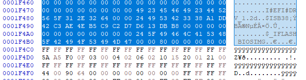

Cut VAS00X64.fd file top data as screenshot, this will give you a 8192Kb file, main image to program.
Resulting in such

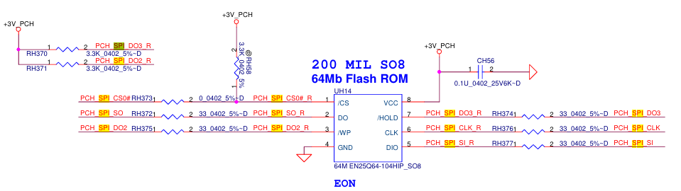

Should be lower UH14…

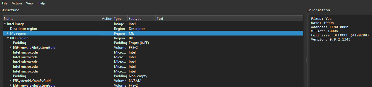

If I can get the EC section of the BIOS separated, do I then flash just that segment to the U2 chip?
