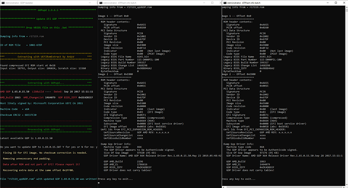

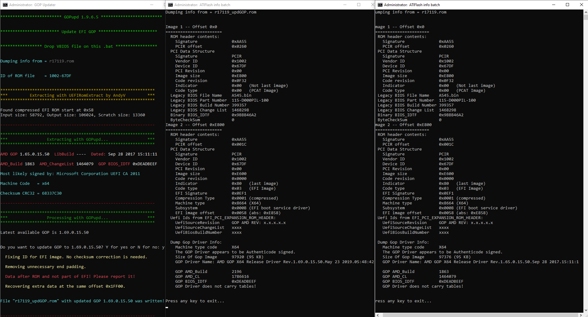

Hi I have an ASUS ROG STRIX RX580-O8G-GAMING OC edition card that uses Hynix Memory
I have followed the instructions as outlined at the top of this thread using GOPUpd_v1.9.6.5_(MAGICgop_AMD_1.69)
here is proof of usage
However, as i have read, the fact the red text states to report this occurance, I am here to report it. It has produced a ROM. When i check the ROM as described above nothing seems to be different.
here is a link the ROM I have used and flashed before to the card to test from the VGA Bios Collection: Asus RX 580 8 GB | TechPowerUp VGA Bios Collection: Asus RX 580 8 GB | TechPowerUp
Please can anyone advise on what is going on.has it been successful? Thank you for the help :slight_smile:
No? Can’t you see GOP driver changed from 1.65 to 1.69?
The app is not developed long time ago, the remaining found data differs from vbios/oem versions.
As any mod, bad or wrong, the user should have backups and know how to recover, nothing else to add to this subject, good luck.,
That is good to know nothing has gone wrong with the update. I will now flash, thank you :slight_smile:
