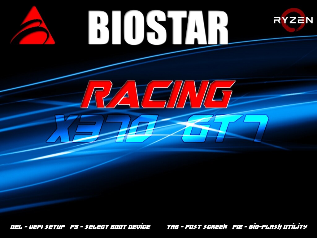

4. New boot logo because the vanilla one is awful (I designed something that seems pretty good to me, feedback on it is welcome I’ll attach it below)

Very weird. The boot screen and BIOS work completely fine for me when I disable CSM. I tried using CSM’s UEFI driver mode instead of Legacy and it worked fine too. I wonder why it didn’t work the first time I disabled CSM. Also can you make the splash screen have a black background? The mobo now displays the splash screen in 1920x1080 so it looks like a little square in the middle of the screen. I think it would look better with a black background.
@barisuraz Give me a little time and I’ll get it done. I’ve also got an updated firmware image from @Lost_N_BIOS with updated REaltek UNDI driver and boot loader let me know when you are ready to do your mods and I’ll send the image your way (complete with edited splash screen :wink: )
