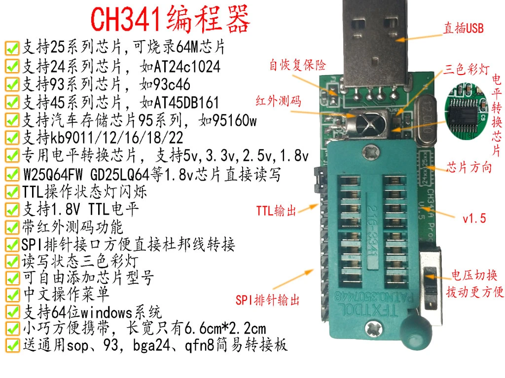

i think ,.,.first must be modded to 3.3V ? ,.,.and for 1.8V chip is best adapter + skypro “gpu mods example”
example for 3.3V mod “ch341a”
https://wej.k.vu/electronics/ch341a-mini-programmer-fix/
edit
or last version CH341A is + switcher 1.8V / 3.3V / 5V “no needs mods” ,.or I’m using SKYPRO 1 + adapter 1.8V - best way for any flash :smiley:
last CH341A
old SKYPRO
