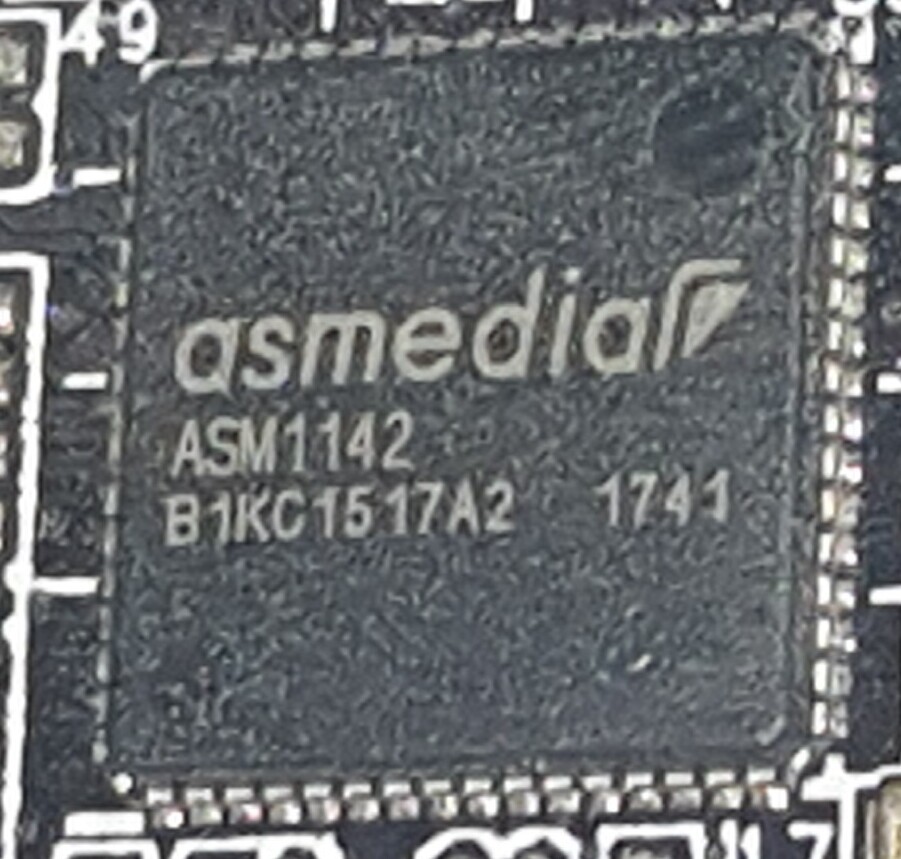

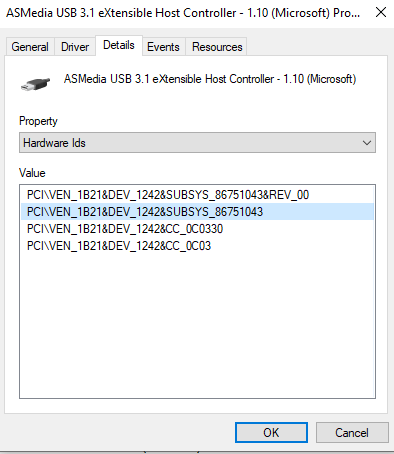

Chip is marked as 1142, Device id is 1242 and Mptools says SVID is 1043? I’m confused.

1043 is ASUS vendor

SSID/SVID has changed but otherwise USB ports still seems to be working (at least not borked :grinning:)

This time I also entered the Asus’ SSID/SVID in the mptool. Seems to be OK so far.
