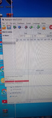

What version of ASprogramner are you using ? I am using ASprogramner 2.1.0.13 and this is what i get as indicated on the image bellow

Another image of the detection of the chip results, it can read ,verify but can’t erase and write
I followed the instruction to the T. Repeatedly , i did edit reg but still not erasing the chip
There is no locked checked status register #2 and #3 all unchecked already but IC still cant erase it
This IC are not locked , is there another why i googled but not winning but getting the locked, unlocked instruction which is not applyingto my situation
