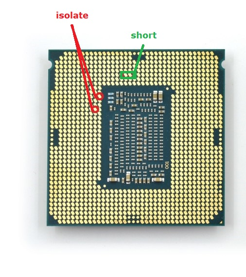

i know i need to isolate/and short pins
here is the image link
http://mblogthumb2.phinf.naver.net/MjAxO…3.png?type=w800
this bios is compatible with 9700k(with pcie graphics card)and overclock it?
and the way to short/isolation pins are right?
please tell me the answer
@chaehwasu Seems to all necessary mods are inside. You need to transfer MAC-address and other personal data using FD44Editor to complete mod. And I would recommend make pinwork as CoffeeTime suggested, not 2 pins only.

@chaehwasu If you need it. Make dump of origin bios for data restore possibility, at the least.
