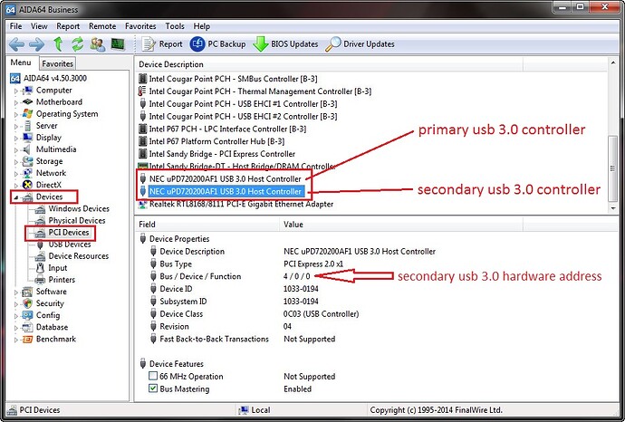

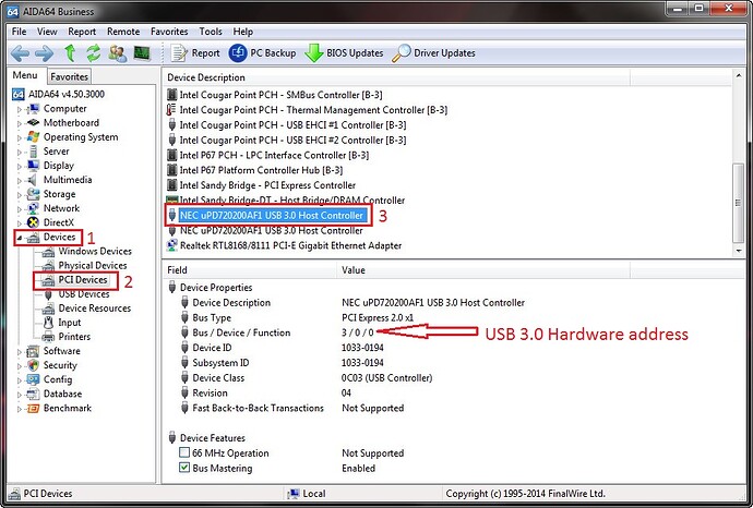

Finding your USB 3.0 hardware address:
-install AIDA64 and run it
-go to Devices then click on PCI Devices
-click on your NEC usb 3.0
Note: if you have two USB 3.0 controller you must find secondary USB 3.0 hardware address
OK in my motherboard Primary USB 3.0 controller hardware address is 3/0/0 and secondary is 4/0/0 ( this is maybe different in your motherboard )

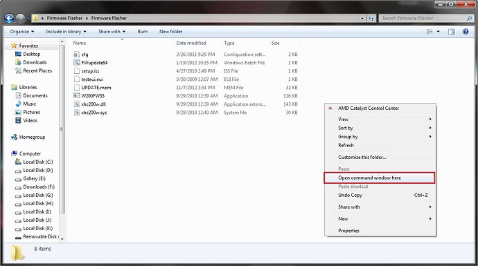

-download and extract Renesas/NEC Firmware Flasher
-in the free space windows page hold shift and press right click and click on Open coomand window here
-now in command windows type this commands to flashing your USB 3.0 Firmware:
w200fw35 /srom 0 /address 03-00-00 /write F402003.mem cfg.ini
Note: 03-00-00 is your hardware address you find in AIDA64 and you must translate your usb 3.0 hardware address. for example: if your usb 3.0 hardware address is 3/0/0 you must convert it to 03-00-00
