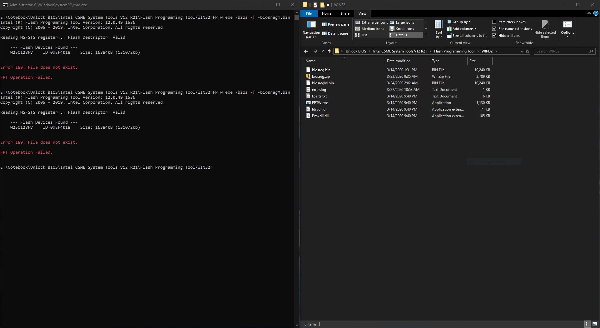

@Lost_N_BIOS
I was checking MD5 through Command prompt.
I flashed the bios as instructed, however I ended up with error 189 as shown in this screenshot
I just tried to re-flash the original as well, and got the same error.

@nlagee2191 - Your image shows you are not at the correct explorer location that contains your BIOS/mod BIOS files (ie “File not found”, since you have browsed to the win32 windows folder for some reason).
Navigate to the correct folder which directly contains your FPTw.exe and your BIOS region files (put bios/mod bios in FPT folder)
I used hex editor to get MD5, but MD5 should be MD5?? Show me how to check via CMD like you did, thanks. Maybe I can see what’s going on there

@nlagee2191 - Nothing is needed on C drive. However, you can leave/run it from C if you want, but then you need to run CMD prompt from that location instead of E.
In your images above 1-2, files are now on C, but you ran command from E, so if mod BIOS no longer on E = file does not exist error
But, I suggest you DO NOT put anything named Win32 on the C drive, because then it may get more confusing in CMD Prompt
Leave all files in place on your E Drive, put mod BIOS there too (I see it’s there in your screenshot), in FPT’s win32 folder on the E drive, run CMD prompt from that exact location

The general reason for this error = File does not exist in location you are trying to run it from
From wherever you are in CMD Prompt, the mod BIOS is not located in that same folder you ran FPT.
So, wherever you run FPT from, also put mod BIOS into that same folder
* Edit, I ran MD5 same way you mentioned, and I get same MD5 as I did previously, so not sure why you are getting something different?
* Edit, If you’ve done that before ^^ maybe due to filename actual = biosregM vs what you put in CMD prompt = biosregm, but I’ve never seen CMD prompt be case sensitive like that
@Lost_N_BIOS
Nothing seems to work. However I am able to dump a new one, and flash it back. Just can’t flash the old one, or the modded one based off the old one. Its like the computer won’t accept it.
Actually I just figured it out…
I kept copying and pasting the command
FPTw.exe -bios -f -biosregm.bin
as you can see theres a - in the filename
@nlagee2191 - I’m still confused, there’s no extra - in the filename, not in what I sent you, not in your folder image, or the command image?
Ohh!!! I see what you mean now!!! It’s in my original post, AND all your images! Very sorry about that!! I will edit it out of that post now, so no one is confused if they run across that and try to use later.
I can’t believe I didn’t notice that in all the FPT attempt images you posted!
