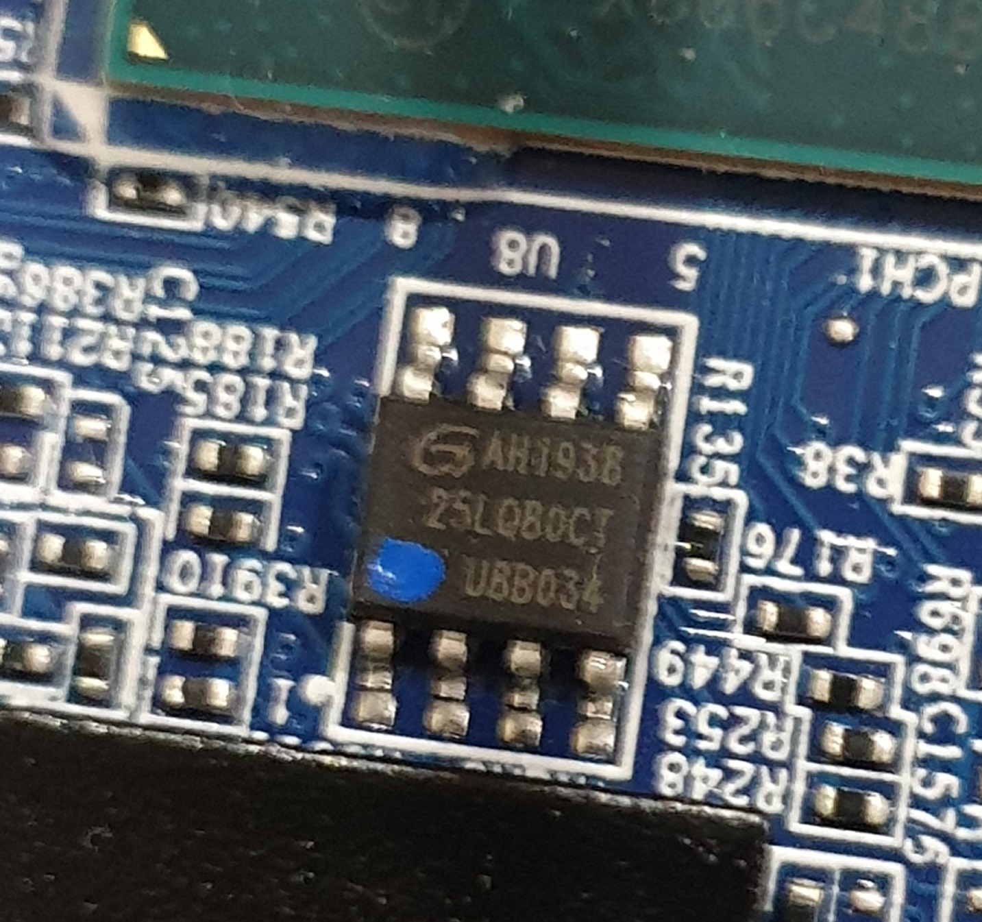

@Lost_N_BIOS - I attached a picture below. Could that be the EC FW chip? It is also near the motherboard chip. If it is, what chip ID should I use to read it?
@Enab - could be, read it and see. This is Gigadevice GD25LQ80 1.8V chip, so you need to use adapter - Use 1.34 software and exact ID

Your 1MB chip dump looks OK, why do you say too short? But, this is Nvidia E4904 SKU 11 VGA BIOS, so not EC FW
Do you see any other similar chips? Look under heatpipes, may be hidden there, or below black stickers/tape, or under memory, wifi or NVME/M2 cards etc
