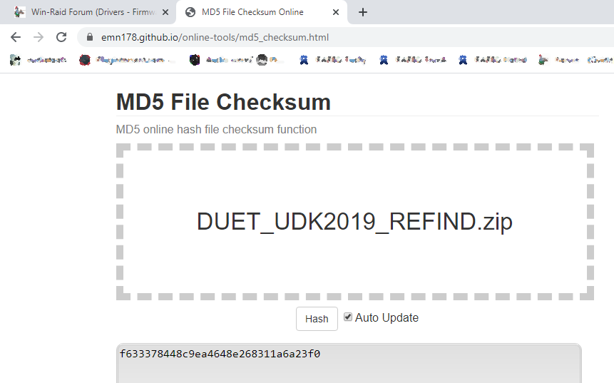

Yeah strange… but as I wrote before, I’ve tried 7zip aswell - same result - and here’s the checksum of the DUET ZIP:
Checksum of ZIP, correct MD5: http://www.sjowall.se/duet_md5.png
@Bankas85
Yea, that’s the current MD5 for the 28-10-2019 DUET ZIP archive.
