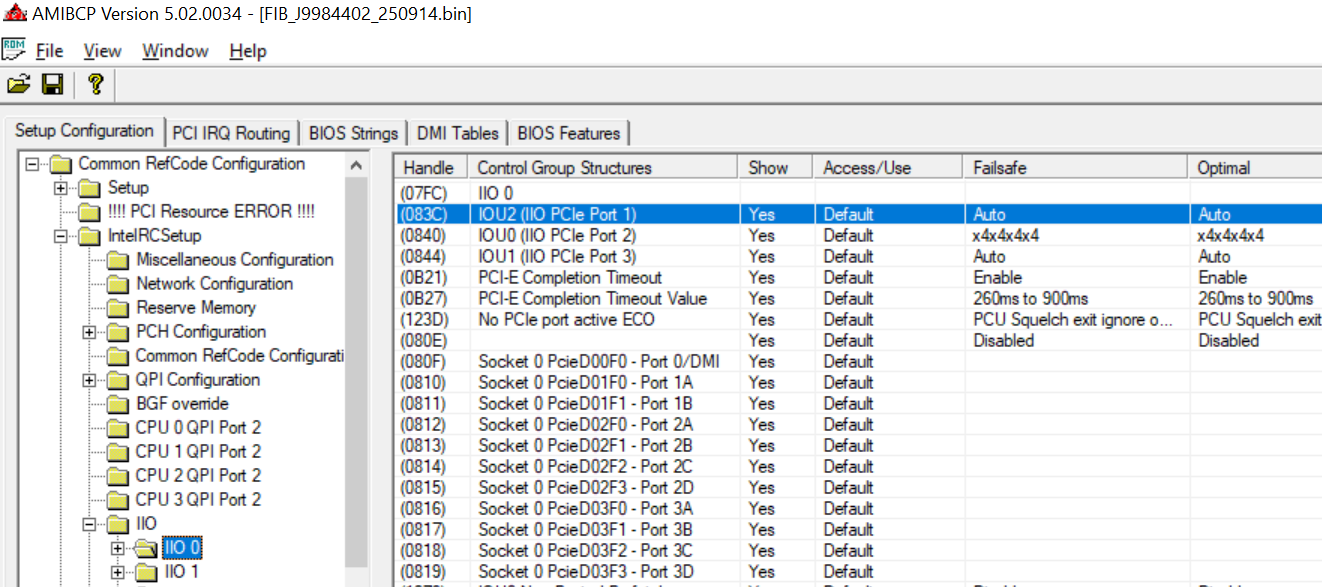

  1. Fixed non-working Ethernet and 100 MHz FSB, by transplanting just the Jginyue BIOS region (8M) into my existing X99D4M4 complete BIOS file (16M)
  2. Fixed the PCIe X4 slot, by setting “IIO 0” to “Auto ; x4x4x4x4 ; Auto”.
  3. Secure Boot and Resizeable Bar is enabled by default, by using AMIBCP

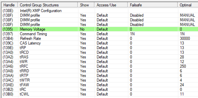

I have not bought any Huananzhi boards, so no experience there. As far as I can tell, only some of the very first high-grade Chinese X99 boards could increase VDDR from BIOS. But once you start to get low enough RAM latency/timings, you get diminishing returns, at least in my own experience (gaming focused). Hardware Canucks had a great video recently, where you can basically slot in your overclocked X99 system somewhere between Ryzen 2xxx and 3xxx (closer to 3xxx). Here is a AMIBCP screenshot of what a finished RAM tweak normally looks like (second hand Samsung ECC RAM). The only thing that is a bit higher than usual is tFAW, due to aggressive automatic tuning of tRRD_L (which in turn forces a high tRRD setting).
If you absolutely need to increase the DDR4 RAM voltage, then I think hardware mods are the only way forward. You can search for “motherboard volt mod” and prepare to dig and learn a lot.

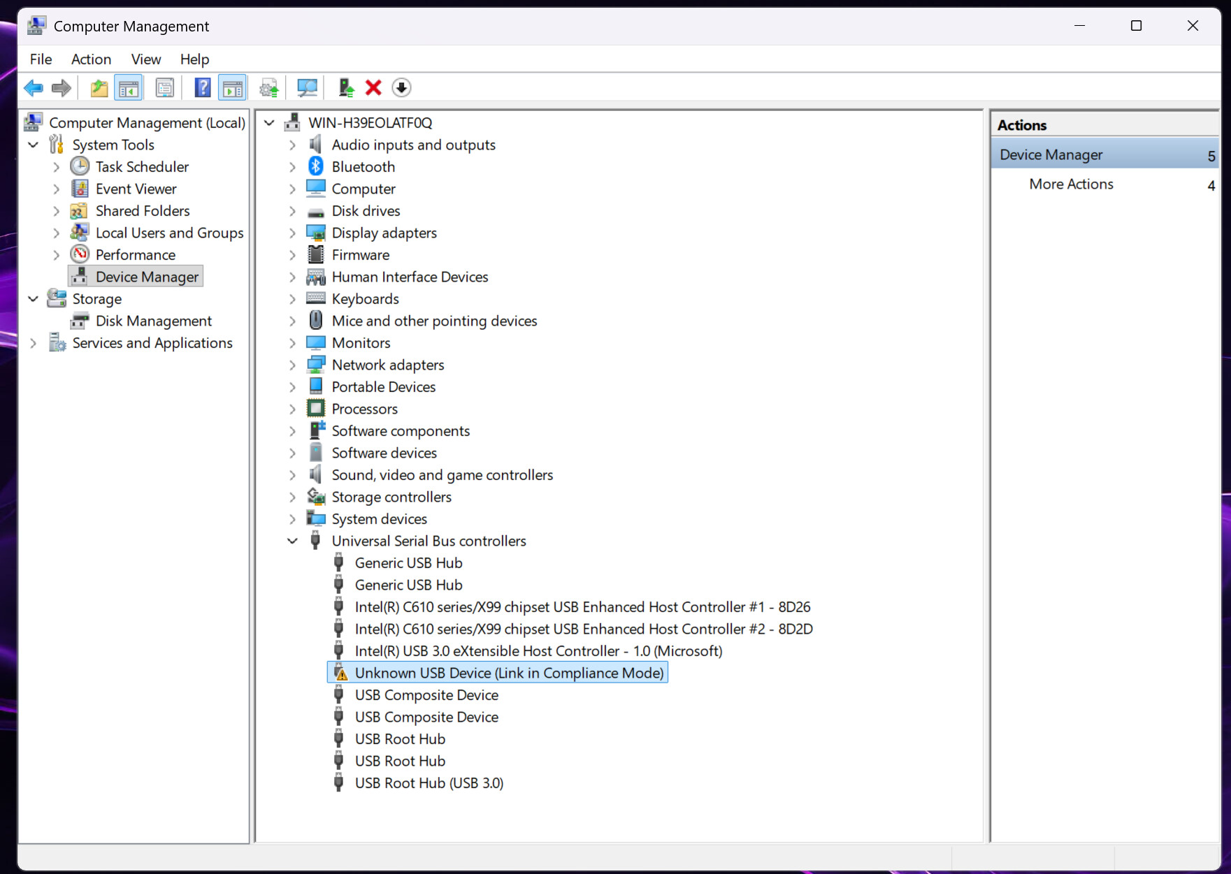

Hello, how to fix Unknown USB Device (Link in Compliance Mode) i am flashed your bios 3.88 MB file on MEGA in https://www.jingshait.com/products-detail/id-310.html works perfect, Thanks
Official Stock bios X99 D4 DUAL PRO mega.nz/file/EJUFhLiY#V4Pf3ws4xC6QH43yIB_qELzu1KLcG9m1qrNBXVL_DAE
Since I do not know the answer to this, I will give you an idea how I would approach it:
  • Option 1: Is everything that you need to work, already working in an acceptable way? If yes, you can just ignore this exclamation mark/disable the device. You can also try updating the driver via Windows update, it might do the trick
  • Option 2: If this USB something device is absolutely needed, then I would start by checking the IIO:s for both CPUs and make them the same as in your original BIOS. See IntelRCSetup/IIO/IIO x/. Due to the enormous amount of NVME disks on your motherboard, I am very sure you anyhow need to double check this. This may or may not fix the USB problem. But be aware that due to potential hardware differences this may be a very, very deep rabbit hole.
  • Option 3: Not likely, but maybe the settings I put in with AMIBCP are the cause of this problem. You can hence try the stock BIOS. And if you happen to have 26xx V3 CPUs, then you can even go with the TBU (Turbo Boost Unlocked) version they provide.
