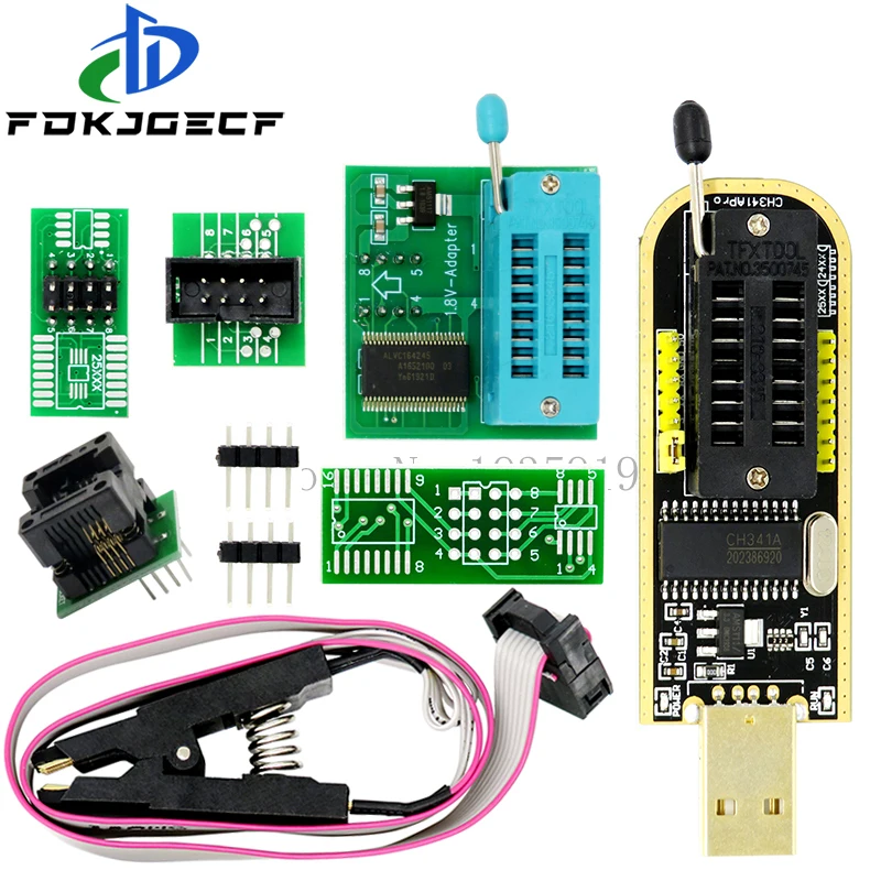

is it possible to flash a 1.8v chip with a 3.3v programmer (ch341a) if I disconnect the VCC ? so I use the power of the board.
( i have a clip )
@MeatWar I found another dump in a forum https://www.mediafire.com/file/z6z465zckn9v1vi/out.bin/file. Can u plz check whether it has GBE partition? If yes how can I use it to edit my bios? Last but not least can I tag plutomaniac when creating a thread saying u forwarded me !
Do u have a green or black programmer? Green is 3.3V but black is 5V. So I think u can take a risk with green one but not black one. It also depends on the chip if it can tolerate high voltages or not. Better use a 1.8 adapter to be safe than sorry later.
black, I was never aware of this 5v issue, flashed already 35 chips with it without checking 5v or 3.3v never did a 1.8 offcourse.
I will do the mod, thx for the eye opener.
For 1.8V you need a voltage adaptor, that fits into the CH341A.
I have the black version with this 1.8V adaptor (from Aliexpress).
https://ae01.alicdn.com/kf/Haf3d9134d3b8ā¦EPROM-Flash.jpg
Source: https://www.aliexpress.com/item/4001269223334.html or https://www.aliexpress.com/item/4001347399521.html
