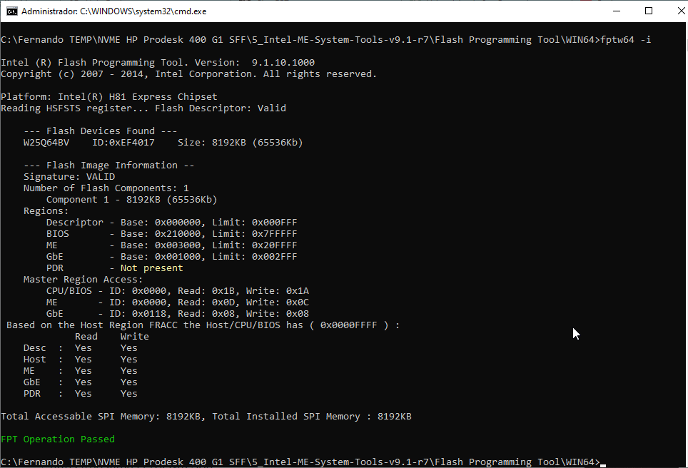

I run the next command:
And all it’s OK

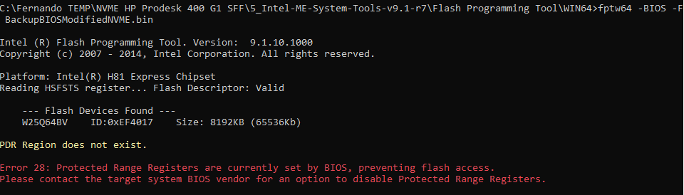

I modified the bios with UEFITOOL 0.28 to insert NVMEExpressDXE_Small.ffs and Ok, but when I’m going to flash the modified bios I obtain the next error:
The BIOS start at 0x210000, but I don’t know whats the value for the -L parameter.

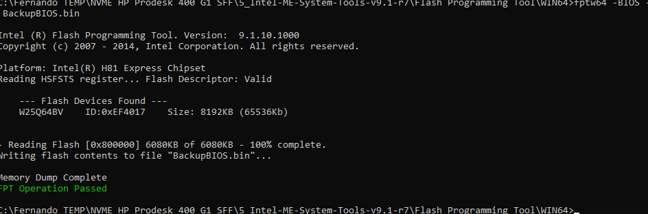

I guess it’s necesary to save an original BIOS with parameter, fptw64 -A 0x210000 -L yyyyyy -D Bios.bin
The original BIOS with the parameter -BIOS is :

After a couple of days of trying I finally succeeded. I also started from the guide published on tachytelic which however does not explain where he got the parameters used for the backup and the bios flash, parameters which cannot be used for the ProDesk as it has a smaller EPROM (8mb vs 16mb ).
Making various attempts with a hexadecimal editor, I discovered that what is done in the guide is nothing more than “cutting” a part of the binary to be flashed, excluding the parts that cannot be written and some corrections that UEFITool makes regarding a "non-empty pad-file”.
At this point I went to find the section of the binary file that we are interested in modifying and nothing else. Another thing I noticed is that if you modify a backup extracted directly from the bios, the modification does not work. I therefore started from the binary downloaded from HP.
The parameters I identified are from offset 0x210000 to 0x7EFFFF, therefore for a length of 0x5E0000.
