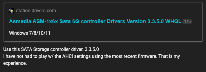

Not sure this helps anybody but I bought a SATA expansion card off AliExpress, one with the ASM1064, 4 SATA ports, I updated the firmware to the one shown here and everything works as it should, I connected 2 SATA drives to it and they’re working just fine too.
What you see linked it’s a Windows driver only, not a Firmware…
EDIT: No worries…was JFYI, all the best.
Oh, my bad, it was 4 am at the time I made that post, I’ll edit it soon to fix that.
EDIT: fixed the previous post, now links to another post where the firmware was linked instead of a post where the drivers were

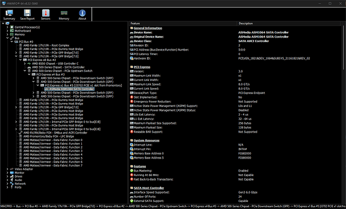

I have an asm1064 controller and now it reports only 4 ports in hwinfo64.
Before it reported multiple sata ports(24).
I installed the station-drivers modded firmware, with the tool from first post.
@berkkocaturk This firmware will fix the slow boot that you have.
