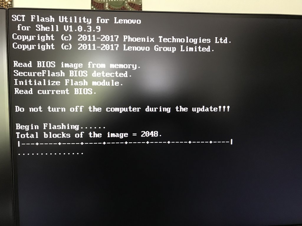

Looks like the systems reboots and uses the flashing in a efi shell?
There might be kinda internal flasher in the bios that programs the EC firmware into this separate chip. I suppose the EC region isn’t accessible via an UEFI flasher since it’s disabled in the flash descriptor, see picture FIT of ‘good’ bios- disabled, size 0.
Edit: I think that these programs aren’t used at all for bios updates. There’s a efi flasher included in the FL1 file.
It triggered a reboot that then ran the update in DOS.
Standard bios update also boots into DOS. It doesn’t really give any details of what it’s updating. This is a screen shot from when it originally bricked. It looks to use the same SCT Flash Utility as the EC update I posted earlier.

@IanP50 Thanks for the picture. Possibly Efi shell, the flasher in last efi volume in bios has text that would fit, the BootX64.efi has a flasher included, too.
But: What do you see after a reboot, when you did flash the bios? Is there just the flash you showed and one reboot, or is there another reboot and another flashing session for transfering EC firmware to the separate chip?
I’m pretty sure it’s just a single reboot. I don’t recall it rebooting twice and doing a separate EC FW flash.

Wait a minute- you tricked the machine into a reboot, didn’t you? That picture is after a reboot, when trying to flash? So maybe if a composed file would’ve contained both bios and EC-firmware…
Boot.zip (406 KB)
I mentioned all that previously, when doing the EC FW flash, it will copy stuff to BIOS or NVRAM, reboot and then stuff actually happens and then on next reboot the changed EC FW is shown within BIOS.

@IanP50 - Your error/image at post #127, that is not DOS?? And “Shell.EFI” is being used, so UEFI/Shell not DOS there also. Be sure you have BIOS in Legacy mode
