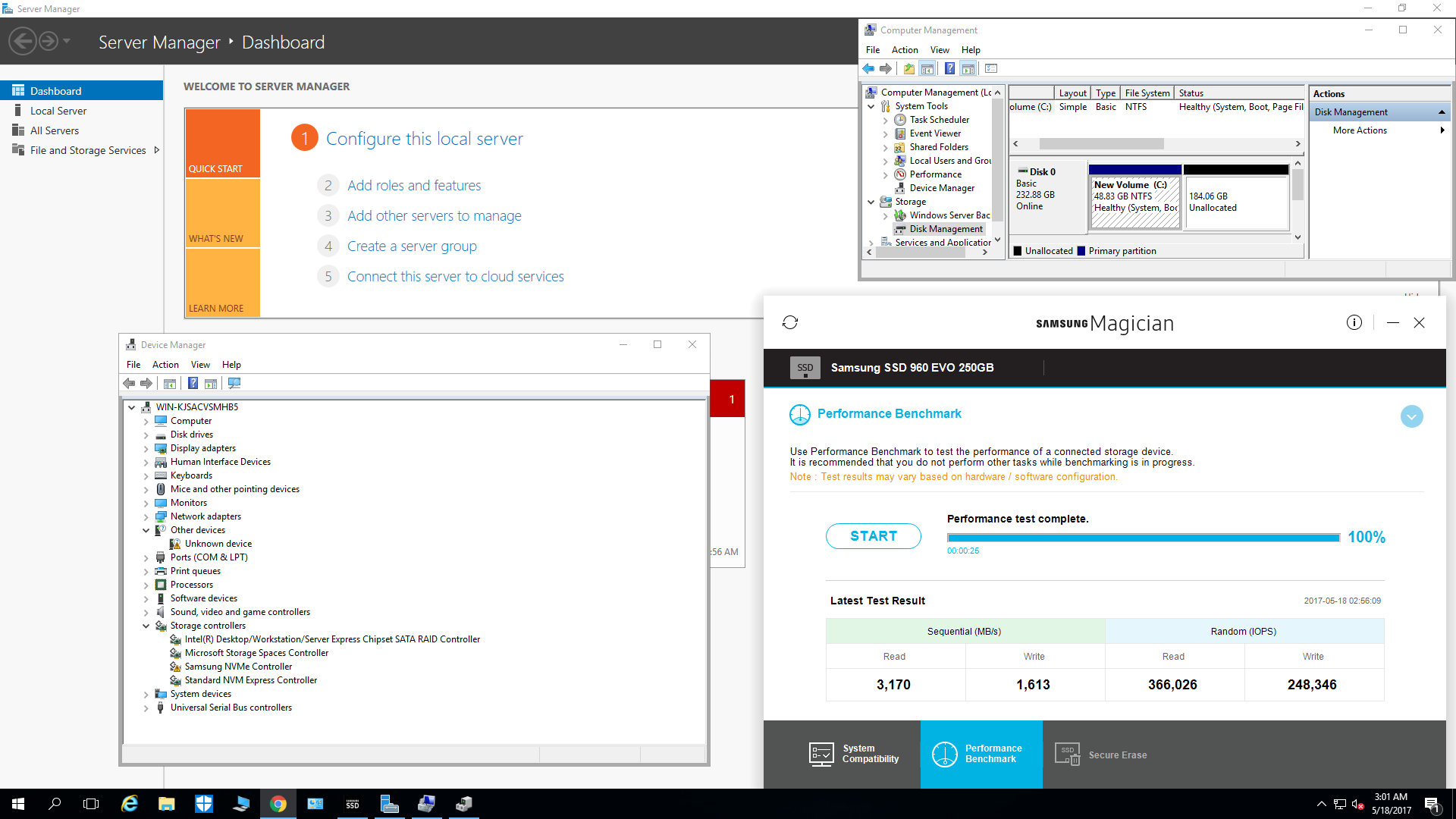

I installed server 2016 because I wanted to know more of this problem but then discovered that the problem does not exist.
the only problem I had was with the samsung driver but as you can see the standard driver works just fine.
