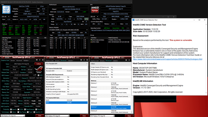

*Screenshot credit to @LyGhT

  • Normal Resizable Bar: Use ReBarSate from here, And Run as Admin.
  • Nvidia Turing (GTX 1600/RTX 2000): Use this, And Run as Admin.
You need to enable Above 4G Decoding for Resizable Bar and Disable CSM/Legacy (boot to UEFI only). To enable it, go to bios → Advanced → System Agent (SA) Configuration → Above 4GB MMIO BIOS assignment and enable it.

  1. Download and check if the ME FW status is unknown using Intel CSMEVDT:
    *screenshot courtesy to @LyGhT

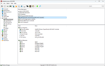

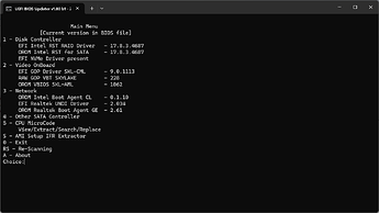

Let me ask/
Are you using:
EFI Intel RST RAID Driver - 14.8.0.2377
OROM Intel RST for SATA - 14.8.0.2377
Is this correct?
If this is the limit for H110, then it is clear.
I have version 17.8.3.4687 working fine on Gigabyte Z370 and Z270.
18.31.51.5346 and 18.35.0.4635 also work,
and version 19.0.1.5466 and newer no longer work.
Thanks/
the stock was 14.8, and updated it to 15.9, since iirc 100/200 would do fine with 15.9 based on the info from the forum.
i never had a raid setup to begin with, so feel free to test it if you do have the board.

This was on stock firmware:
  • 17.5.0.4136 on Z370PD3
  • 15.5.0.2875 on Z270PD3
And? You’re talking here about H110 chipset not 200 or 300, more recent/modern versions of the OROM/EFI are not compatible. And nothing to do with OS drivers…
And only a system using a RAID volume will take advantage of updated ones… not NVMe or AHCI disks on a system.
Explain what’s your doubt on this…
No, no doubt. Question out of curiosity, I mentioned the H110 chipset above.
Rather, the question is whether I am using version 17.8.3.4687 correctly?
I don’t have an H110 to test it.
For RAID-massive, you need identical HDDs, which I don’t have.
Thanks/
Yes, v17 its correct for 300 series, you’re ok cause as you mentioned, not even using RAID setups.
