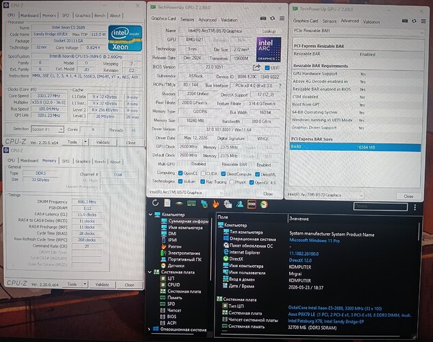

*Credit to @Skogsmannen39 from github for the screenshot.

Thank you so much for this mod, I have been trying fo the longest while to get above 4g decoding working, but this works very good with my Intel Arc a750 LE and Samsung NVme M2.
Trim support is working on raid and non raid ssds, rebar 8GB works.

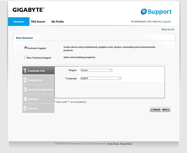

for Gigabyte, you can do the same on their eSupport web, just set the region when about to make a mail to Taiwan and languange set it to english, like this:
