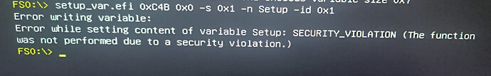

Tried to change “Password protection of Runtime Variables” via efi shell and got this error. Any workaround?
I can do a ch341a flash with my modified image, but I want to be able to use FPT to flash the BIOS after External flash. My mobo makes it a lengthy procedure because the SPI chip is at backside of the mobo.
Are you using the same motherboard (Asus ROG Strix B760-I)?
If so, which BIOS version are you running? If not, is it at least an Intel-based ASUS board?
An empty nvram.txt file usually indicates that the following settings weren’t enabled.
  • Setup → Tool → Publish HII Resources: Enabled
  • Setup → Advanced → UEFI Variables Protection → Password protection of Runtime Variables: Disabled
If these options aren’t available, you’ll likely need to use a hardware flasher and follow the steps above. Alternatively, you can check if anyone has found a model-specific workaround for reading / writing to your motherboard.
