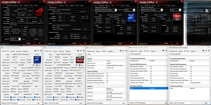

How To Enable Resizable Bar
  • Normal Resizable Bar: Use ReBarSate from here, And Run as Admin.
  • Nvidia Turing (GTX 1600/RTX 2000): Use this, And Run as Admin.
You need to enable Above 4G Decoding for Resizable Bar and Disable CSM/Legacy (boot to UEFI only). To enable it, go to bios → Boot → Above 4G Decoding and enable it.

i succeeded flashing this bios on my Z97-a (rev. a) motherboard using the “AfuWinx64” version 3.05.04. After enabling ‘Above 4G encoding, disabling ‘csm support’ and rebooting, i tried using the nvStrapRebar (my gpu is the RTX2080 OC) and going for target ‘13’ (8gb). After saving and exiting, i verified with gpu-z and i can see that rebar is disabled still.
Any advice what to try next?
@my03 Run nvstrapsrebar (use release 0.4-rc1, since the module i use is v0.4-rc1) as admin, press E, press P, enter value 32 and enter, press S, and reboot.
Check Device Manager → View → Resource by type → Large memory → see if your gpu is listed there.
Thx heaps,
the rc-1 worked. While i couldn’t find that specific option in device manager, i can now see it enabled via gpu-z :slight_smile: (bar0 16mb, bar1 8192mb, bar2 32mb)
Huge thank you
By bad, i was looking at “drivers by..” and not “resources by..”
I see the gpu listed and its enabled. All good.
