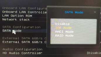

I searched the entire bios but could find neither the option to disable secure boot nor the other for fast boot.
maybe try to set this:
Sata Mode: AHCI
External Sata 6GB/S: Disable, Save and exit, go to bios again and see if your drive is listed.

no. it did not go well. installed the disc, and enabled ahci
result
restarted the machine and set everything in ide again, as soon as I entered windows everything crashed

After what has been said in the past few days, I have set everything in ahci. In the bios and under windows. I have been using the system this way for a few days now to try it out.
In previous conversations you told me that if you connected the m2 drive, before modifying the bios, it was seen by the system as a storage disk. Is that correct, or have I misunderstood?
The problem arises when I connect the m2 disk with adapter to the pcie.The disk is not even seen by the system as a storage disk.
Windows does not start , it goes directly to bsod or it starts and after a few moments on the desktop bsod again.I can start it in safe mode, but the m2 drive does not appear in any way, not even in disk management.

I have searched in the bios to see if there are any options I can enable/disable, but I can’t find anything in particular.
intel rapid start tecnology disabled
intel smart connect technology disabled
AHCI intel sata enabled
External Sata 6GB/S disabled
SATA Controller not set to “RAID”
is it a motherboard problem? or windows again? does the disk m2 have to have some kind of special formatting? i left it as it came, so ntfs.
