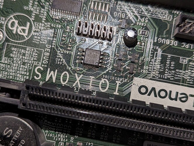

After LOTS of trial and error we tried something similar to this post, where we took the BIOS section from the P320 BIOS ROM that you can download from Lenovo and replaced the entire BIOS section of my BIOS that I read with CH341A.
The P320 has the code and the option to enable the 4G decoding. So after patching that frankenbios with ReBAR I was able to set it to Unlimited.
Modding the CH341a to use 3.3v
The MX25L12873F in question that needed flashed
