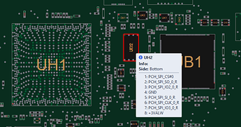

Hey btw, for this did you use the SOIC clip method to program the chip in bios? I mean the part where you connect the black clip directly to the bios chip in laptop motherboard?
SOP8, identify the IC model and respective voltage, clip it, read the content, it contains the system board original data.
Hey there @MeatWar. Greetings, and thank you for your response. Im aware of the c341a method of writing or programming bios chips as I have once modded and fixed my old nvidia graphics card once. My concern here of doing the laptop to my laptop motherboard in future is that if this can cause powerbleeding and lead to incomplete writes or detection issues in case..
As long as the IC is correctly identified and no overvoltage to IC or SPI circuit, all it needs is the right app, a good clip and stable grip to IC Pins…not much to add here, you have the skills/steady hands for it or not. Similar to GPU card flash…
