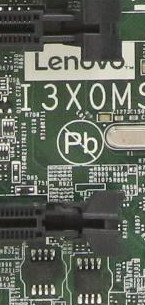

Hi Guys,
I had a softbrick during the upgrade of my Lenovo ST50 (ThinkSystem) - Type 7Y49CTO1WW- SN/J3025GH4 IC :MX25L12873F
I did the dump via CH341A and got this 16MB file corrupted after the soft brick.
Stupidly I did not make a previous backup.
I downloaded the ITE138A_ST50_12MB.ROM from Lenovo’s site to try to flash it as a .bin but being 12MB it is not digested by the MX25L12873F chip
Via chatgpt I created a new 16MB file by merging the dump and the .ROM file but it failed.
I’ve put here every file I citated:
https://drive.google.com/drive/folders/1RaKoCNThsBUe4UdRyf_m1HcwEgbr5iG2?usp=sharing
If I plug the pc into the socket now the fan starts at full speed and it doesn’t even beep anymore.
I hate Lenovo
Thanks for helping me guys :sob:
Edit by Fernando: Thread title customized
I think this system board has 2 ICs…
