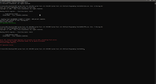

I have now inserted the ReBar Module into the dumped BIOS however I am stumped on figuring out how exactly I can now flash this. I have tried using Dell PFS Bios Assembler/Extractor to create a BIOS update file with the modified bios however I don’t think that’s compatible with my BIOS version (1.27.0) as it appears to be missing some things when extracted so I am unable to reassamble it back into an update file. I have also looked into using Flash Programming Tool but its not allowing me to write:
I have thought about using a ch341 programmer to write to the bios chip itself but I do not have one on hand. Is there any other way to flash this modified bios onto my laptop?

My bad, i thought it was a pc motherboard atm :joy::pray:t6:. I think you should use ch341a to dump the bios chip only and compare it with the fpt dump, to see if both dump have any differences before proceeding with flashing the bios.

just to answer directly to the error message you got when trying to flash ( not sure if this is just the first error, followed by a bunch others as there is alot to do regarding flashing modded bios, and not from the DELL Bios process, i have no clue….
But could try this :
Flash Protection Range Registers (FPRR): setup_var 0x10D8 0x1
