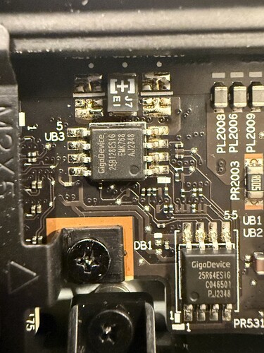

SPI work:
  • Dumped BIOS via CH341A (GD25B128E main chip)
  • Verified dump integrity
    • 16MB size
    • Multiple reads match (bit-for-bit identical)
    • No write performed yet
Note there is a second, 8MB chip i can upload too if needed.
