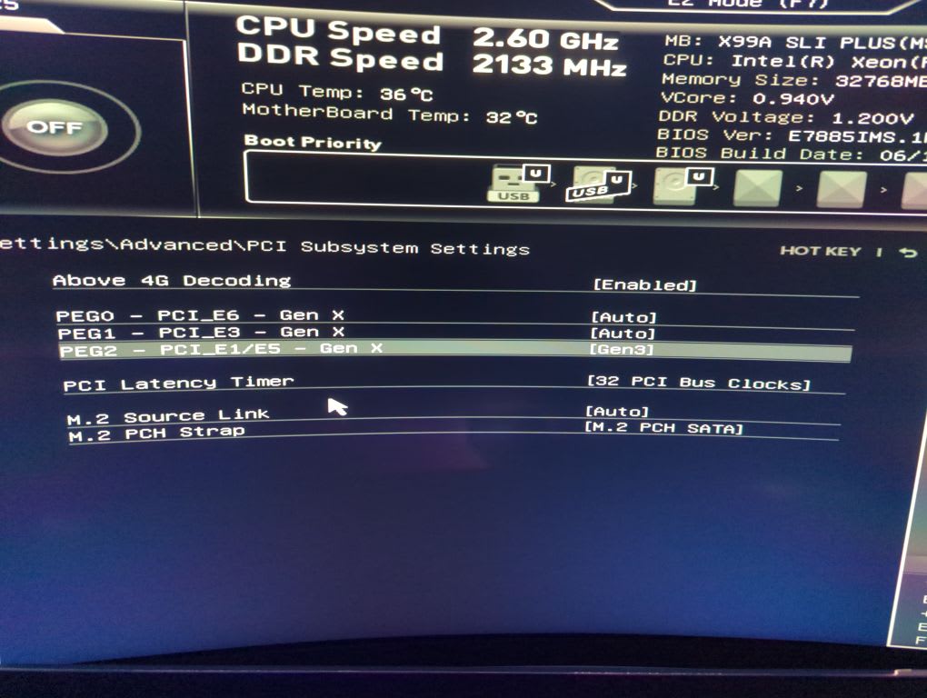

1. BIOS Settings Adjustments
  • Enabled “Above 4G Decoding” in BIOS.
  • Set PEG2 (PCI_E1/E5, primary GPU slot) to “Gen3” (instead of Auto) to force PCIe 3.0 compatibility.
  • Left PEG0 and PEG1 on “Auto”.
  • M.2 Source Link: Set to Auto.
  • M.2 PCH Strap: Set to M.2 PCH SATA.
  • PCI Latency Timer: 32 PCI Bus Clocks (default).
  • Screenshot of current settings attached:
    ![BIOS Screenshot]1

Screenshot of current PCI Subsystem Settings:
![BIOS Screenshot]1

Problem solved!
Solution: Card went back to dealer. Ordered a proper nvidia card. 5070ti works out of the box.
thread can be closed.
I see that the problem has already been solved, but I want to leave a comment
I encountered a problem with the RX 9060 XT on X99a SLI in Windows 10 and Server 2022. It looked like the video driver was not working. As it turned out, the issue was present ReBar being enabled.
As soon as the Bar size exceeds 8Gb, the driver stops working. What is most interesting, everything works in Windows 11. It also works in 10 without ReBar enabled. And it works with ReBar enabled on an old video card with 8Gb VRAM. I have never been able to find out what the root cause of the problem is.
